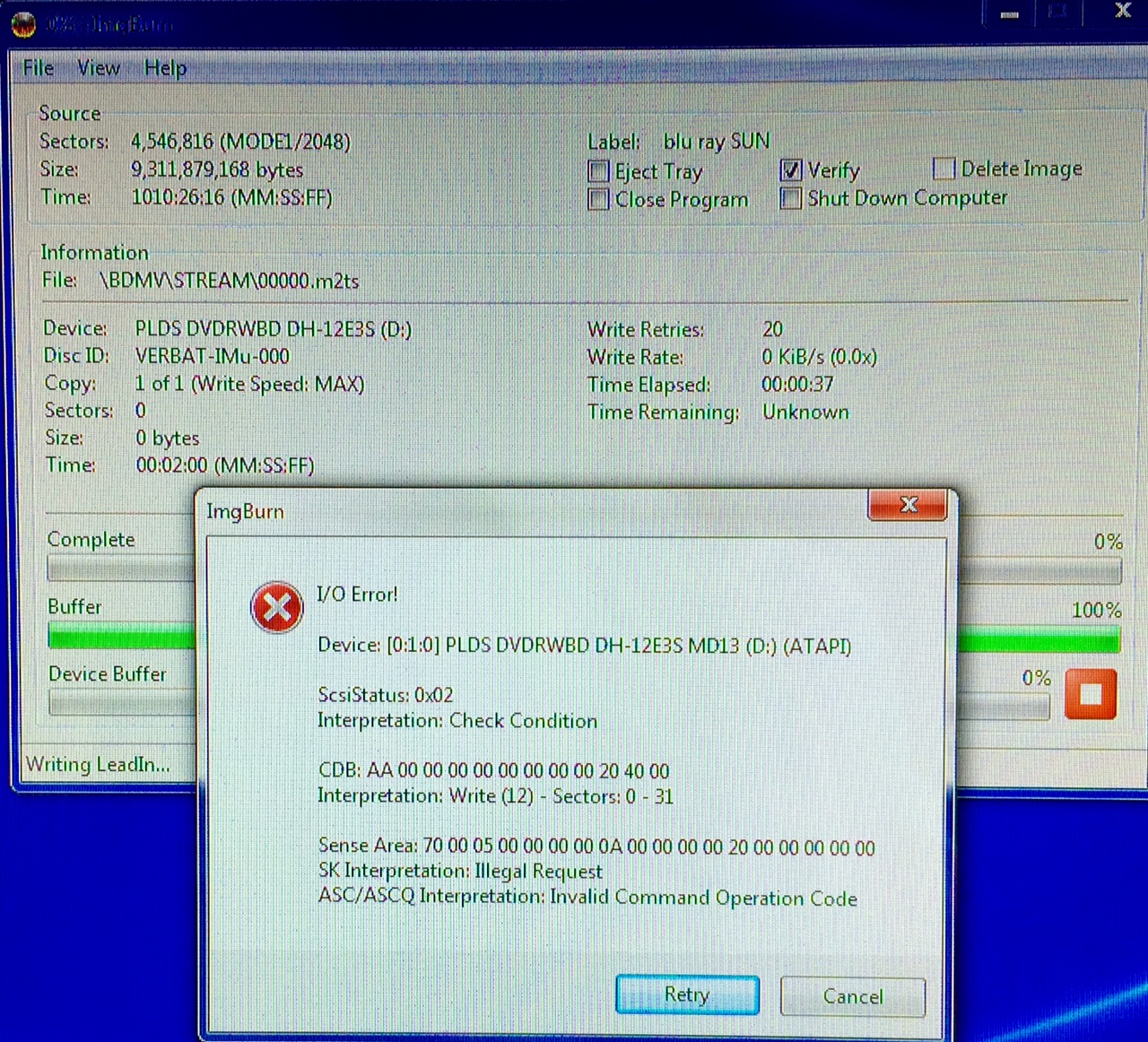

    Hi,
    Not sure if there's a technical problem or if I'm just doing something wrong as this is my first shot at making/burning Blu Ray, although I think I've done it all correctly...
    I use TsMuxeR to output 3 m2v video files + 1 PCM WAV audio file as Blu ray folder.
    The folder with original files is 8.04GB, when output through TsMuxeR as Blu ray folder the output file is 8.67GB (is it normal for it to be that much bigger when I'm wanting to be doing this losslessly?).
    Then in write mode I drag/drop the BDMV and CERTIFICATE folders into ImgBurn, when I hit burn I then get the following error, I have attached a photo of the error in this post.
    Does anybody know what the error is?
    *maybe worth noting, my PC often errors when burning dual layer DVD's, but the same files burn perfectly on my laptop, maybe this Blu ray error is also specific to my PC?, unfortunetly though my laptop doesn't have Blu-ray so I can't check if it will work on that, but then again maybe this error doesn't have anything at all to do with my PC/burner...
    [Attachment 38533 - Click to enlarge]

    PROBLEM SOLVED.
    The Blu-Ray in old PC and laptop can read Blu Ray but not write Blu Ray....
    I think my stand alone / home theatre Blu Ray will be able to burn it off a USB though...
