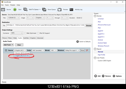

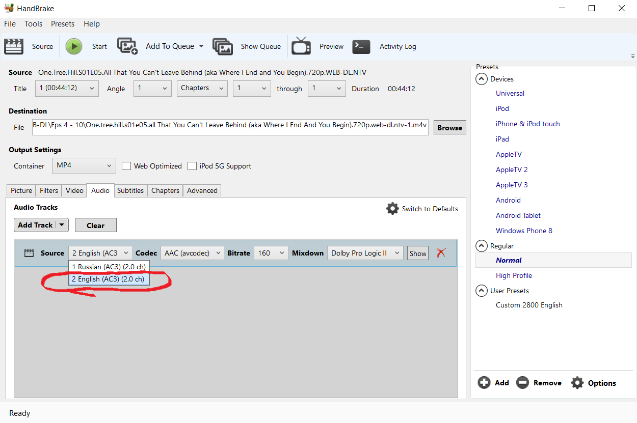

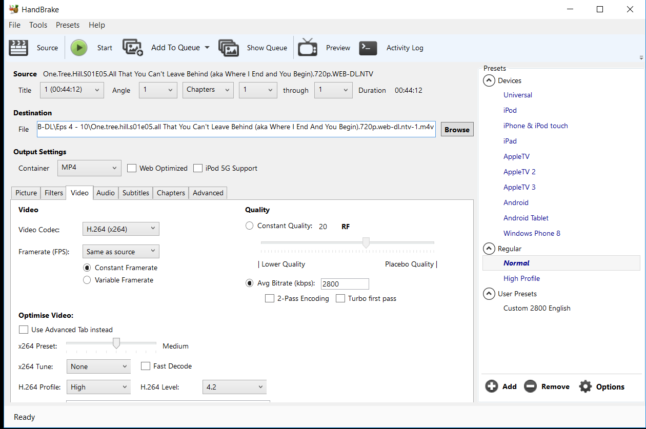

    If I load a single file into Handbrake - either by drag and drop, or using the Source menu - Handbrake will hold the settings I input. So for a single file this would be an example of settings I'm using (selecting the English option on the Audio page) - No filters or Chapters selected:

    Handbrake will then produce a file @ the correct 2800 kbps, Constant FPS, High 4.2 and English output.
    But as soon as I load a Folder using the Source > Folder menu, and Add All to Queue, Handbrake stops using those settings. Handbrake will run two pass, with a Turbo first pass. It will produce a file ~ 1900 to 2200 kbps, in Russian, even though I've selected the same Video settings as the single file, including selecting English Audio. I've even tried adding these settings as a Preset, then selecting that Preset after adding items to Queue, and then checking to see that English is selected.
    Is there something I'm missing here in order to get Handbrake to use my inputted settings for Queued items?
