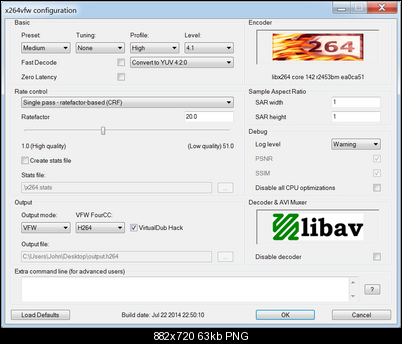

    Xvid doesn't support odd resolutions. So it can't do 225.
    h.264 isn't a great match for AVI files. But using x264vfw isn't much different than using Xvid. I recommend you use a version which support presets and pick the preset that suits you and the appropriate tuning for your source. Use Single pass ratefactor based (CRF) and the ratefactor you want. If you're going to output to AVI enable the "virtualdub hack".
