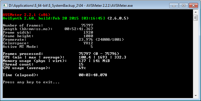

    I had avisynth.dll 2.6.0.3 and AVSMeter 2.2.1 wouldn't run. So, I simply copied avisynth.dll 2.6.0.5 to C:\Windows\SysWOW64 folder (nothing in the C:\Windows\System32 folder)
    This is a screenshot of AVSMeter 2.2.1 of one video:

    Obviously, a very different average fps.

  9. I think the bottleneck is the cineform encoding. Decoding isn't the bottleneck, and you don't even need to use MT
    I would run multiple simultaneous instances of vdub, maybe 3-4 since your CPU usage was 25% if your storage setup is fast enough

    As for the MT, I commented out that line and ran the test again, this time the average fps jumped to 368.2 fps, so I guess you're right about not needing it for this type of file. (I think the video is vc1, not h/x264, I don't know how to tell the difference in an .mkv file)

    AVSMeter 2.2.1 = 360.46 fps
    VirtualDub 1.8.8 = 367.46 fps (only opened the script, under Video -> Fast recompress, and ran the test, no codecs selected/changed)
  13. So cineform is your bottleneck.
