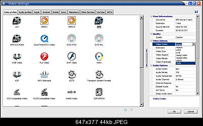

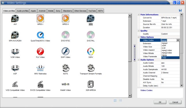

  4. If I re-encode the entire mp4 with both the video and the aud
    How about an encoder that can "copy" the video and only reencode the audio like XmediRecode, MediaCoder, Video to Video ...
  5. videobruger: I am certainly willing to give it a try. I can drop the mp4 into the video to video converter and select direct stream copy but it doesn't give me an option of re-encoding the audio. I can select to convert the file instead of direct stream copy to mp4/AVC but that doesn't give me an option of not re-encoding the video along with the audio. Thank you for your suggestion.
    If someone can point me to a guide to do this process. What I did before was demux and select the audio and convert and then remuxing the converted video with the audio but then I ended up with out of sync video and audio. Thanks in advance for any additional information.
  6. My LG Blu Ray player is the LG-BP325 and I like it because it plays .divx files as well and I wouldn't want to lose that functionality.
  7. I can select to convert the file instead of direct stream copy to mp4/AVC but that doesn't give me an option of not re-encoding the video along with the audio
    Like this
