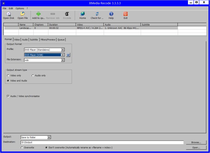

  6. Perhaps easier with XmediaRecode.

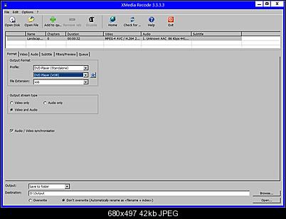

    As Format use DVDPlayer (standalone)/VOB

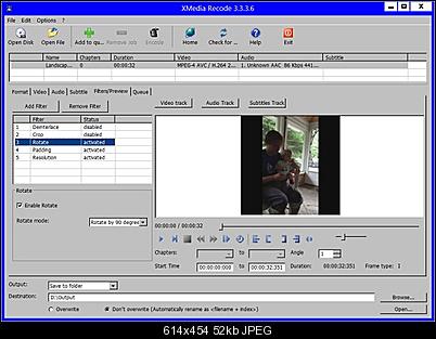

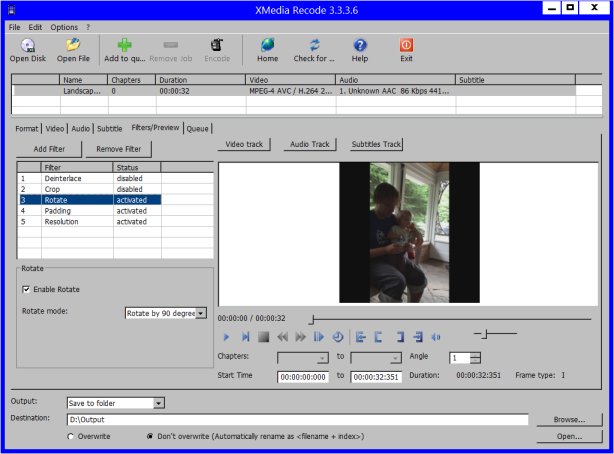

    On the "Filter" tab use "Add Filter" to add the "Rotate" filter and then "Enable Rotate"

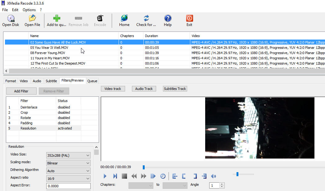

  10. Will the encoded version show up on the dvd? After I did what you said, add to queque then encode it still shows up sideways when I go back to it in the program.Click image for larger version

  13. From the screen dump from XmediaRecode that the "Rotate" filter is disabled, ie no rotation is done.

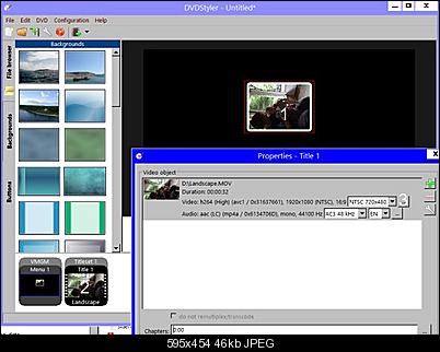

    Use DVDStyler.

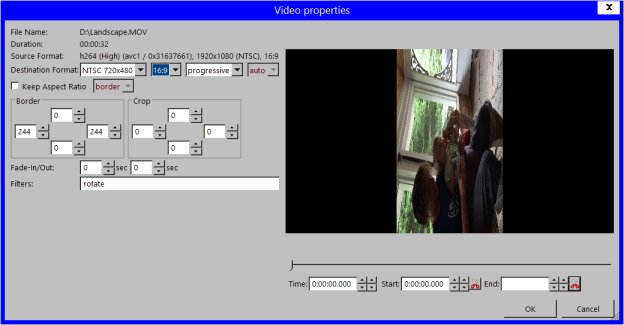

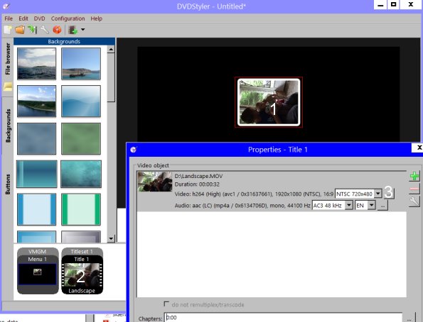

    Create a NTSC project without a template. Drag "02 Som Guys Have All the Luck.mov" onto the empty menu (1). Double click on "Title 1" in the bottom of the window (2). Click the three dots for video (3).

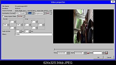

    On the Video Property windows that pops up use "rotate" for Filter. Select "Border" (= padding) and use a value of 244 for each side (16:9 aspect)

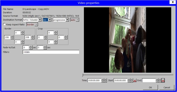

    For 4:3 aspect use 208 for border.
