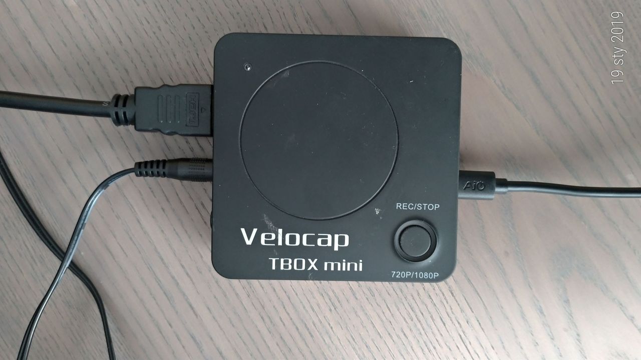

    I have this equipment, exactly YK928R Ver1.0(20150813) on PCB, pretty old, but still in use. Unfortunately I flashed it with firmware I found on internet (cloner-allince, they have the same device), it works, but it limited bitrate to 10mbps, while originally this device was grabbing to 16mbps.
    Can you send me that firmware you mentioned in your post? Link is not working anymore. I wrote to manufacturer but didn't get initial firmware.
    What software do you use to grab videos, if you grab to PC? My card originally was delivered with something called 'Tevii' and I wish I had something more functional and with better interface.

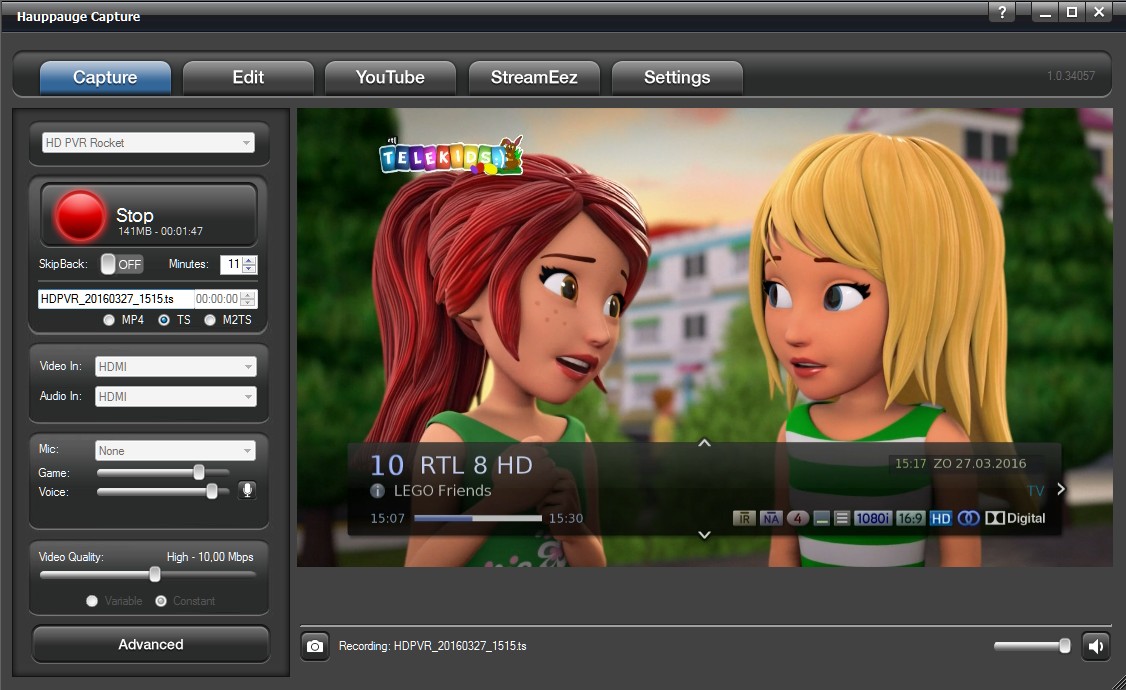

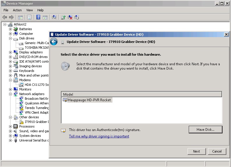

    But you can install the capture box as a Hauppauge Rocket PVR device and use their capture tool, that works very well.
    http://www.hauppauge.com/pages/support/support_capture.html
    You need to remove the included capture software and (manually?) install the included drivers with the Hauppauge capture tool.
    Also in my experience it works best to capture in TS format to avoid A/V sync issues.

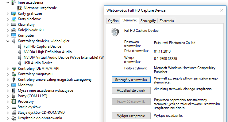

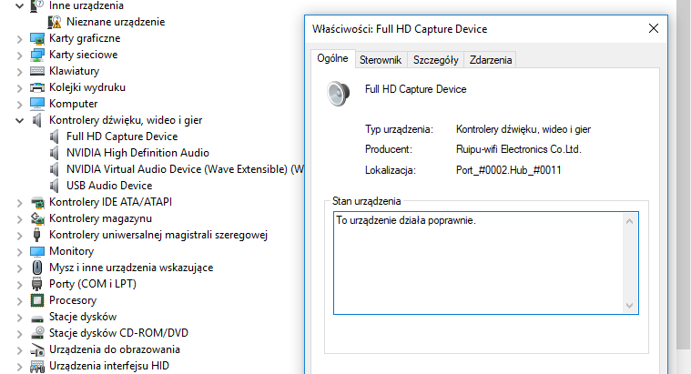

    Hi. I'm very glad for info to use Hauppauge Capture software ( I installed hauppaugecapture_1_1_36187). That solved most of my problems. I can record several hours without any A/V sync problems. Max bitrate I can set 17.5Mb (max selectable in software is 18Mb but it hangs app, so I have to relaunch it). I only miss feature to split files during recording after certain size or time. I like very much countdown recording timer (especially needed when no file splitting)
    So these are drivers (different than yours) that are working with my card:
    [Attachment 47996 - Click to enlarge]
    [Attachment 47997 - Click to enlarge]
