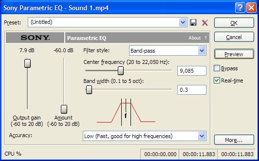

    IF Scotts suggestion does not help, there may be something you can do in Sound Forge that may help a bit.
    When I listen to it, the worst thing is that it has a harsh, screechy sound - you can clearly hear it at just past the 7 second
    point on the clip you provided
    In Sound Forge, open the the Parametric EQ and try to isolate just that sound. (here's a place to start - you could open up the
    band width a little more to make it easier).
    Once you're satisfied you can best isolate that harsh sound, switch it to filter style band notch/boost
