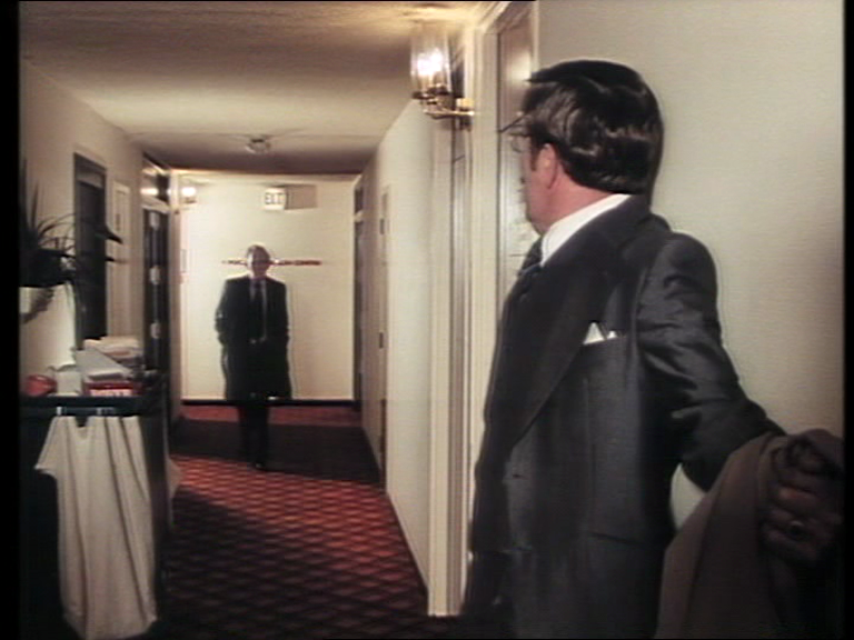

  1. Trying to find a means of removing or at least minimizing ghosting (faint outline of objects offset slightly to the right of the objects) on some original DVDs.
    Have been searching for various plugins/scripts for removing or minimizing ghosting for use with AVISynth and/or for use with other similar software.
    There are a few plugins/scripts found so far, but it appears as though they require a pointer to specific individual files for processing, and may not (or can not) do "batch" processing (processing all videos on a DVD for example) via DVD-RB for example(?) They may also leave unwanted "side effects" such as brightened or darkened areas etc(?)
    So what I'm after is a plugin/script that will allow batch processing of multiple videos from a DVD, and will not leave any unwanted artifacts on videos, and (preferably) can also automatically detect the ghost image offset without having to specify offsets manually.
    A detailed and clear explanation of what settings should be used in these plugins/scripts would be very helpful, as it is often not clear what settings should be used.
    EDIT: Added screenshot from an already reduced video (from DVD-9 to DVD-5). The ghosting is present in the original video, the shrinking of the video did not introduce ghosting.
    Ghosting on right side of people and objects is more noticeable on the gentleman in the middle of the screenshot. Less noticeable for the gentleman on the right and for the left side of the frame.

  2. I have a sample video clip taken from another DVD. This clip has not been processed, it has been taken directly from the DVD.
    The clip shows some grain and/or noise, as well some "ghosting" on right side of people and objects.

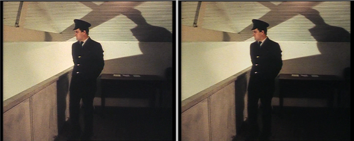

    Here's a quick attempt in VirtualDub. I put a Levels filter ahead of Exorcist to rebalance the picture.

    Not necessarily. It depends on the sharpening filter. Though, JVRain's Exorcist image looks pretty good. This comes pretty close to what he did:
    ColorYUV(gain_y=-128) # half bright to prevent overflow in Overlay()
    shifted = last.Crop(0,0,-2,-0).AddBorders(2,0,0,0).ColorYUV(gain_y=-160) # the video shifted right by two pixels, and darker
    Overlay(last, shifted, mode="add") # add them together
    ColorYUV(gain_y=115, cont_u=-128, cont_v=-128) # readjust brightness and saturation
    Using SmoothTweak() rather than ColorYUV() at the end may look a little better. And this leaves a bright halo above horizontal edges, like Exorcist did.

    Thanks. But which level filter was used, and what were the settings used for this filter?
    What is this "rebalancing" of picture, and when should this rebalancing be used?

    Aug 2010
    San Francisco, California
    Originally Posted by brispuss View Post
    Thanks. But which level filter was used, and what were the settings used for this filter? What is this "rebalancing" of picture, and when should this rebalancing be used?
    I used the Levels filter that comes with VirtualDub. The Exorcist filter has a side effect of changing brightness and contrast, so after tweaking it to get rid of the ghost, I went to the Levels filter (which I placed before it in the chain) and played with the input levels to get the image looking like the original again. I think I turned off "operate in luma only" option.
