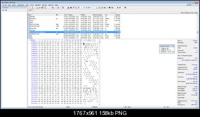

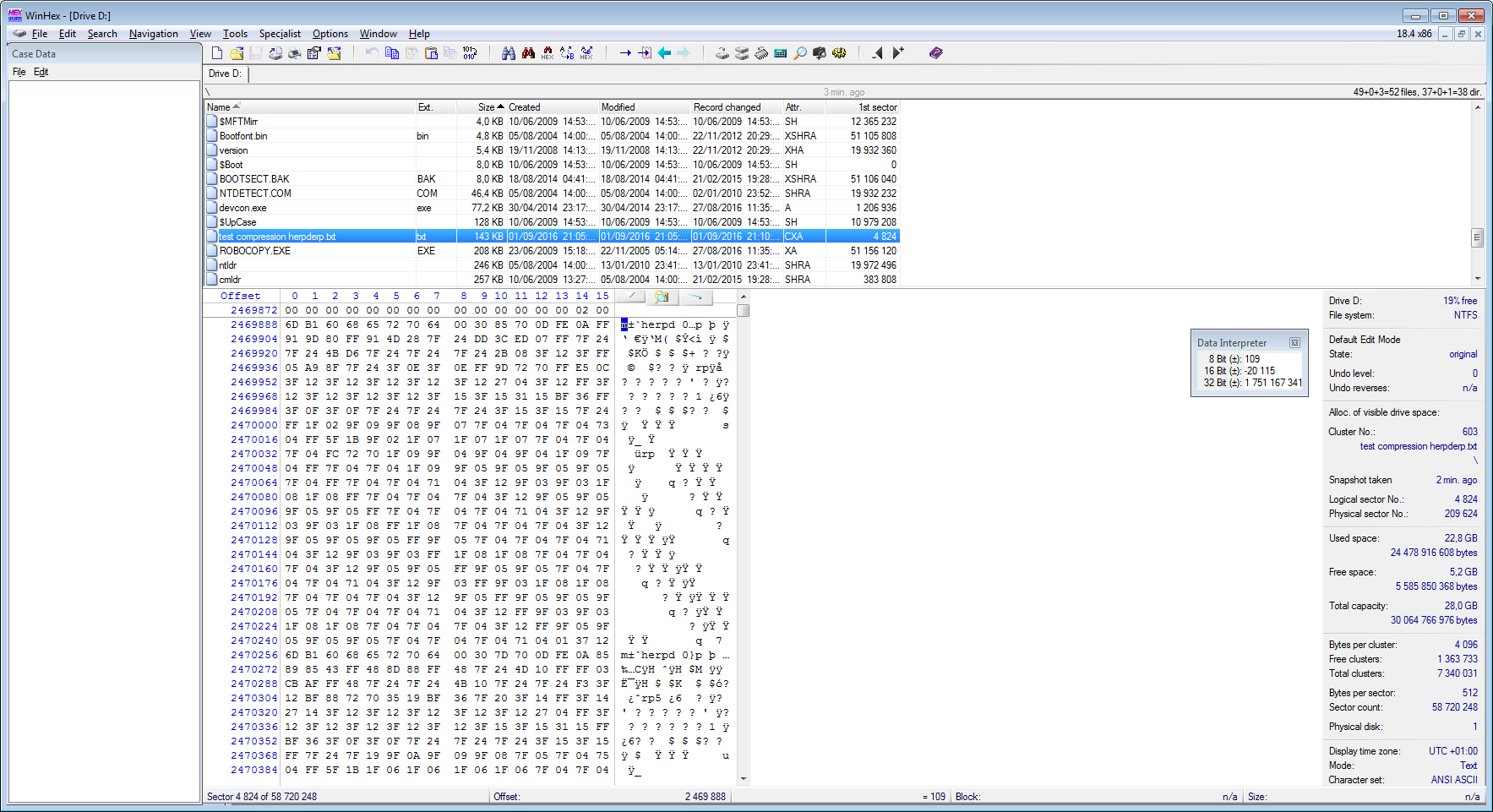

  13. Is NTFS file compression and sparse files the same beast with different names?
    Note quite, from what I understand. NTFS compression does compress, don't know exactly how or how it actually appears on the drive (now I know, see below), but the file size is significantly reduced when a file has a lot of redundancy even if there are no empty parts. For instance I created a file with 1000 lines of “herpderpherpderp....” (as if I hadn't more important things to do ! ;^p), actual size is 145998, size on disk is 147456 (= 36 x 4096, or 36 4KB sectors), if set to compressed it gets down to 20480 (5 sectors). If then accessed with an hex editor like WinHex which can open the whole volume (to bypass the normal behaviour of the system which is to uncompress the file on the fly) it appears compressed indeed :
Name:	herpderp WinHex.png
    That compression is not very efficient though : if the same file is compressed in ZIP, size gets down to 868 bytes, 288 bytes in RAR (set to “normal”), 264 in 7Z (default settings).
    The “sparse” attribute is just supposed to remove blank / empty parts, keeping the rest as is -- yet the “size on disk” always appears to be the same from what I could see so far, even when there are indeed a lot of empty parts, so it's even more mysterious. If I take my herpderp file, replace lines of “herpderp” except the first, the last, and one in the middle, with either spaces or “00” bytes (while keeping the same size, so there should be empty sectors), it appears exactly the same in WinHex if set to “sparse” or not... Maybe the empty parts must be bigger than that, or it doesn't work like that at all, can't say more at this point.
    If sparse files rely on NTFS file compression that may be the problem. I'm somewhat sure file compression is an option you select (or not) when a drive is formatted and I'm more than somewhat sure I've never enabled it. Would that be why I'm not seeing any sparsness?
    No, that's independant, there can be compressed or sparse files even if the volume hasn't been formatted as “compressed” (and there can probably be non-compressed files on a volume formatted as “compressed”, just like a folder which is set as “compressed” can contain non-compressed files). If you set the “sparse” attribute with the fsutil command you should see that the “size on disk” appears identical to the actual size, and a new “P” attribute (with Windows 7 at least -- just tested with Vista : the “P” doesn't appear).
    And then, going back to the origin of this off-topic discussion, if you attempt to copy that file with Synchronize It! v. 3.5, the copy is going to be corrupted after exactly 25000 bytes (not with v. 2.8).
