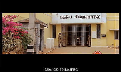

    i have interlaced video to resize after cropping the borders my video size is 1920x540,
    i want to resize to 1920x1080 using avisynth without deinterlacing.
    what is the best filter to do it.

    before cropping the video
    here is the media info
    General
    Complete name : C:\Users\Gankum\Videos\ _160722_211522a.avi
    Format : AVI
    File size : 1.31 GiB
    Duration : 13 s 560 ms
    Overall bit rate : 831 Mb/s
    Video
    Format : YUV
    Codec ID : YUY2
    Codec ID/Info : YUV 4:2:2 as for UYVY but with different component ordering within the u_int32 macropixel
    Bit rate : 829 Mb/s
    Width : 1 920 pixels
    Height : 1 080 pixels
    Display aspect ratio : 16:9
    Frame rate : 25.000 FPS
    Color space : YUV
    Chroma subsampling : 4:2:2
    Compression mode : Lossless
    Bits/(Pixel*Frame) : 16.000
    Stream size : 1.31 GiB (100%)

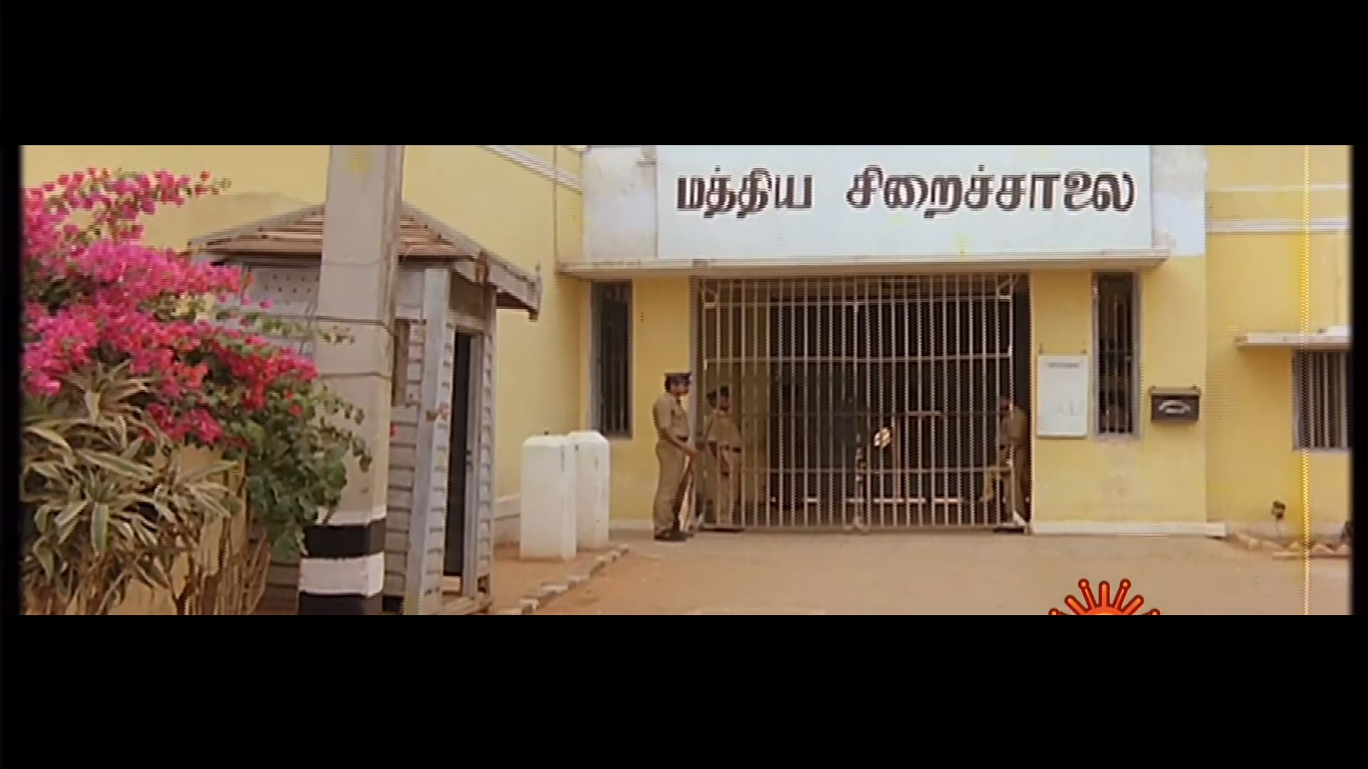

  11. Your image is obviously stretched horizontally. The active picture should "normally" be in the 800 - 816 range, not 540.
  12. The video is obviously upscaled from standard definition. If you resize the image to 1440x1080 the aspect ratio looks about right. That would correspond to a widescreen movie in a 4:3 DAR SD frame, upscaled properly. If you then crop the top and bottom black bars you're left with 1440x680, a 2.11:1 aspect ratio. That's not a common movie aspect ratio so maybe it was zoomed a little from a 2.35:1 movie.
    The frames are interlaced but the content is progressive frames captured out of phase. Use TFM() to recombine the fields to make progressive frames. And follow up with vInverse() to remove residual comb artifacts (from compression artifacts).
