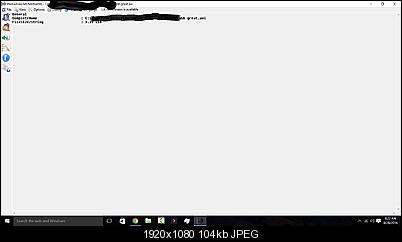

  1. Earlier tonight i was screen capturing with cam studio for about 45 mins and then i save it as avi file. it saved as an avi but it wasn't playing on vlc player and it wasn't playing on wmv player either. it wasn't playing on no media player period . so i figured that the avi file was corrupted so i download divfix ++ and it said input file is not an avi file. so i download hex editor and usually it say RIFF for a avi file but it didn't all i got was the picture that i have attached can someone please give me any advice on how to salvage this video.

  2. Member DB83's Avatar
    Jul 2007
    Download mediainfo and post (text mode) the report of the file

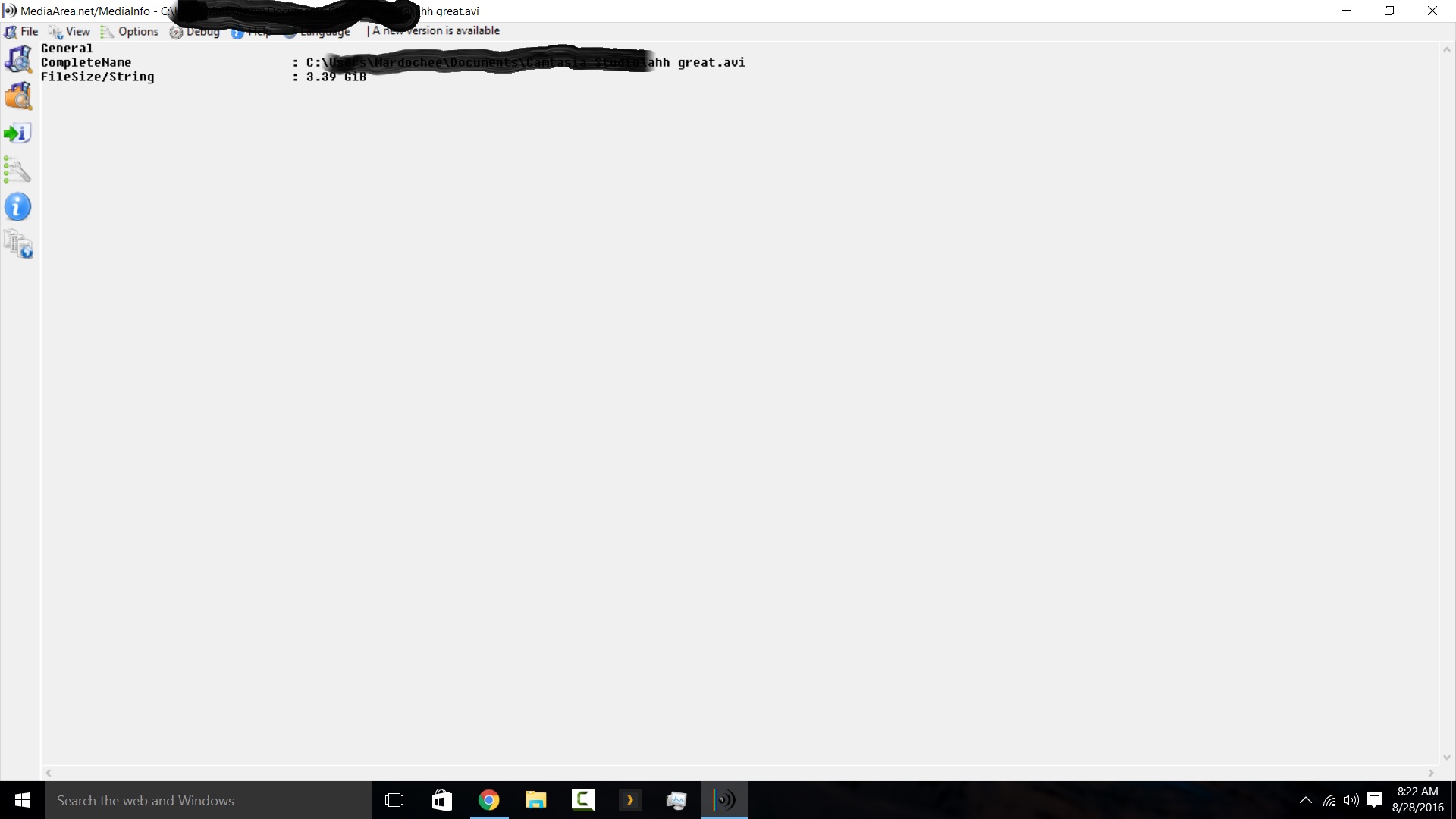

  3. Click image for larger version
    this was all i got
  4. Member DB83's Avatar
    Jul 2007
    Do another short vid.
    But it looks corrupt. Also not a good idea to capture/convert to your main OS drive. That could be the issue and a HDD OS write when you were either capturing (so did not get what you thought you were getting) or converting could have caused the corruption.
