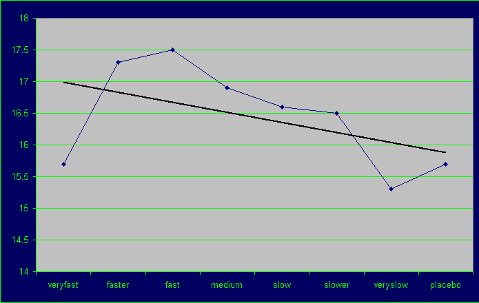

  9. ultrafast: 32.8 MB
    superfast: 22.5 MB
    veryfast: 15.7 MB
    faster: 17.3 MB
    fast: 17.5 MB
    medium: 16.9 MB
    slow: 16.6 MB
    slower: 16.5 MB
    veryslow: 15.3 MB
    placebo: 15.7 MB
Name:	jagabo's numbers.PNG
  10. Drawing a trend line doesn't preclude the fact that there is a dip at veryfast and it takes several more presets before the size dips down below that. Nobody's arguing that the general trend isn't downward.
    No. Higher (slower) presets give better quality.
    This is exactly opposite of what you, and many others, have said about the relationship between CRF and presets in the past.
    The mantra has always been that CRF denotes a given quality and the presets determine the final size; i.e. CRF 18 + ultra fast will produce the same quality as CRF 18 + placebo only the former will use more bit rate to accomplish the same quality.
    In this thread, you, and others, have completely contradicted a decade of accepted CRF theory. If as you say at slower presets CRF ups the bit rate then CRF is, as I have always believed, pretty much useless.
    Here's the explanation for what the OP is observing, the slower presets make use of various psycho-visual enhancements that faster presets do not and as you get to the slower settings the psycho-visual settings get more aggressive as well. If you read up on x265's psycho-visual algorithms, and x264's for that matter, you find that various settings will actually pump up the bit rate in CRF mode in order to avoid artifacts.
    On the x265 website there is an explanation related to psy-rd and one other psy setting whose name escapes me at the moment, where it states that if you set the associated settings too high you get artifacts due to portions of the picture being bit rate starved as the algorithm tried to move bits around. To prevent this, in CRF mode, setting the psy optimizations too high will balloon up the bit rate to try and avoid the artifacts.
    The takeaway here is that x265 is a steaming pile of garbage that shouldn't be used by anyone for anything, unless you have a raw sewage fetish.
    Thank you.

    It wasn't accepted theory, only a common misconception. CRF is not an absolute measurement of quality. It wasn't that way with x264 either. It doesn't make it useless, it just means you shouldn't use CRF to compare different settings without taking the bitrate into the equation.

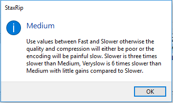

  21. I know, but I was under the impression that Preset was used to only influence compression. Slower the preset, better the compression. That's not happening at all.
    And that is what the software says too.
  22. "Better compression" doesn't mean "lower filesize". It means "lower filesize at the same quality". Since same CRF does not guarantee same quality you can't conclude from your test this principle has been violated.

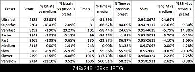

  28. I did small test with x265-8bit, CRF 22 to measure differences in bitrate, quality (SSIM) and encoding time. I used Simple x264/x265 launcher with command: --preset xxx --tune ssim --ssim. I replaced x265 build with 2.0.52. Test was done on 720p clip.
    x265 [info]: HEVC encoder version 2.0+52-6ee705ecb433
    x265 [info]: build info [Windows][GCC 5.3.1][64 bit] 8bit
    x265 [info]: using cpu capabilities: MMX2 SSE2Fast SSSE3 SSE4.2 LZCNT
    P.S. My CPU (Pentium G3220) does not support AVX/AVX2.
Name:	x265 CRF 22.jpg
    It seams there is a bug in preset optimization with veryfast and faster because encoding time and quality is almost equal. Same thing happend with 2.0.2 build that comes with Simple x264/x265 launcher.
