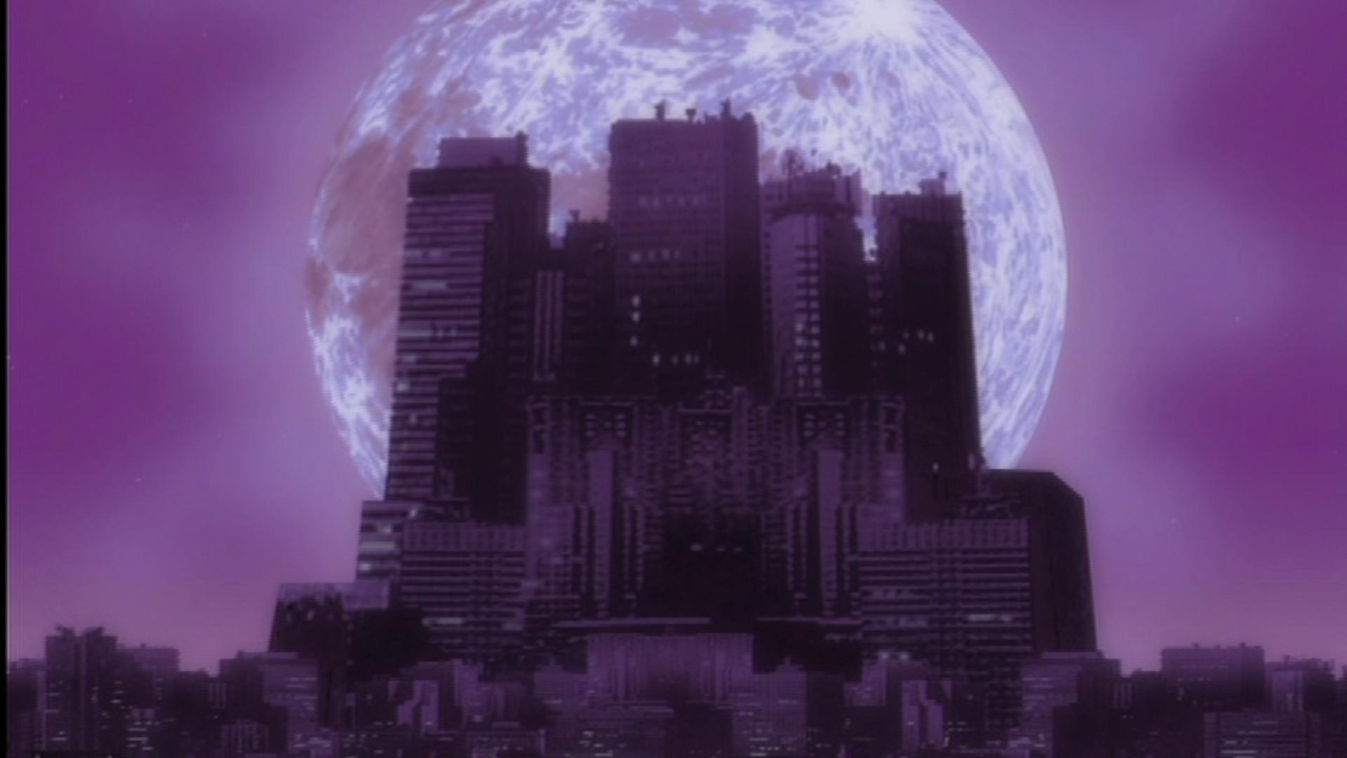

    here (1,2) an example of an encode i made (just the sample not the whole EP)
    is it good?
    here is the script

    9.What is this transparent lines at the bottom left side of the video (appears trough all the video)
    is there a way to get rid of it witout cropping it? (there are already black bards to crop)

    c.i added source VOB sample for the video i made and the other one (the one i called "fast pacing")
    d. do i need to shift the color left or right if a crop?
    for example if i just choose to crop the black bars at the side and ignore the "transparent lines"
    I've added two samples could you show me what script you would use ? (also if i would want to apply the 60fps how the other filters should be arranged?)
    thanks for the help buddy
