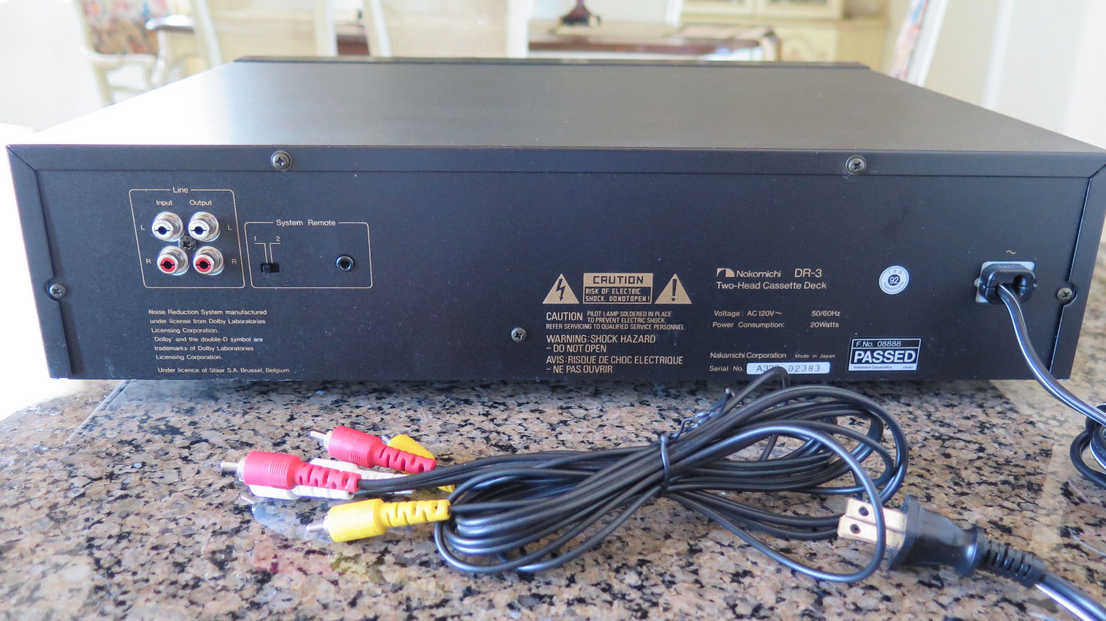

  3. I only have budget for one ^^; The walkman and cassette deck are priced similarly at around $100 each. I was hoping for someone who has experience in this to advise me which one to get. I have attached a pic on what the audio outputs looks like.
    Aug 2006
    Get the casette deck. It's a Nakamichi DR-3, and should be better than a Walkman. You need a converter cable similar to this: https://www.amazon.com/Dynex-Mini-Stereo-Audio-Cable/dp/B0032JAG4G/ They are often available in the electronics department of general merchandise stores.

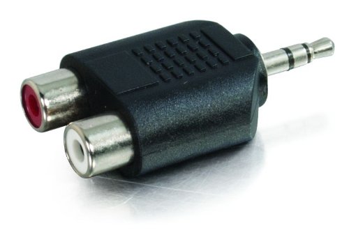

  5. I used a cassette deck 15 years ago to convert all of my decent sounding cassettes to digital, I used CD Wave Editor to capture the audio. Audacity is a better solution nowadays though. The important thing to remember when capturing is to keep the peak input levels below 100(0dB), otherwise you will clip the audio. You will need the adapter below which you can find on Amazon. Click image for larger version
