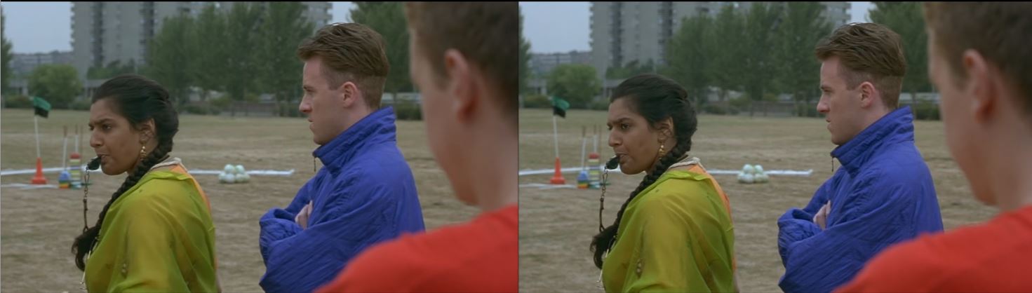

    i dont them to play side by size id different windows , i could figure it out myself.
    i want 1 to play on half of the screen an the other on the other half
    some thing like that
    http://thisiscolossal.com/wp-content/uploads/2011/06/split-2-600x337.jpg
  4. Here's a batch file that builds an AviSynth script, then plays it using a specified media player. Drag/drop two video files onto the batch file.
    echo v1 = DirectShowSource("%~dpnx1").Subtitle("%~dpnx1") > sbs.avs
    echo v2 = DirectShowSource("%~dpnx2").Subtitle("%~dpnx2") >> sbs.avs
    echo v1 = v1.Crop(0,0,v1.width/2,v1.height) >> sbs.avs
    echo v2 = v2.Crop(v2.width/2,0,v2.width/2,v2.height) >> sbs.avs
    echo StackHorizontal(v1,v2) >> sbs.avs
    "G:\Program Files\SMPlayer\smplayer.exe" sbs.avs
    del sbs.avs
    Note: if you're using 32 bit AviSynth you must use a 32 bit player. Both videos must have the same height and color format (YV12, YUY2, RGB...).
