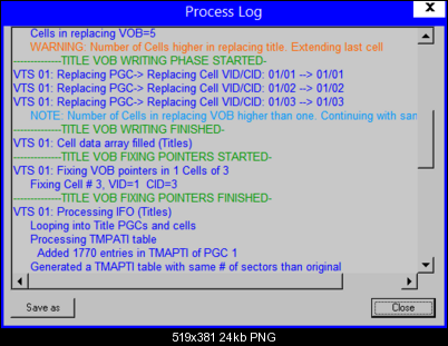

  6. Let me try to clafiry and start by saying I remembered wrong.
    Case: I have a PGC with 3 cells and want to replace it with a PGC having 5 cells. What I remembered was that only cell 1-3 to would be replaced and cell 4/5 skipped. So I had to test. What happens is that 3 cells is maintained after the replacment but cell 3 is extended to include cell 4/5.
    Sorry for any confusing this may have caused.

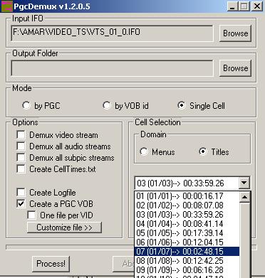

    I'll assume the cell numbers are the same for both DVDs - there's a chapter for each song. I'd open the IFO for the DVD section of this concert in PGCDemux. You said this part of the concert had its own VOB, which says to me it's in its own PGC and has its own IFO. So, open the IFO for this section in PGCEdit, choose to split by single cell and choose to create a PGC VOB. There's a picture below of how to set up PGCDemux. Set up folders for each of the songs and demux them one by one into folders 1, 2, 3, 4, etc. Or however you want to name them. When done you'll have a bunch of VOB files, but you need DVDs. I'd then reauthor them in IFOEdit.
    Open a VOB in IFOEdit, In the bottom center 'Create IFOs'. give it a destination and 'OK'. Do this for each until you have a bunch of little DVDs, one for each song.
    Once you have all the little DVDs of each song/chapter/cell, open the original DVD in VobBlanker, choose the correct VTS for your concert so that it opens in the bottom screen. Highlight it in the lower screen and hit 'Cells' over on the right and in the new screen all the songs/cells are listed. Highlight a cell and hit 'Replace' and replace the old with the new for each. When all done hit 'Apply' followed by 'Close' which brings you back to the main screen. Give it an 'Output Folder' and 'Process'. When all done be sure to test the new DVD thoroughly before burning to disc.
