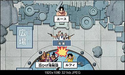

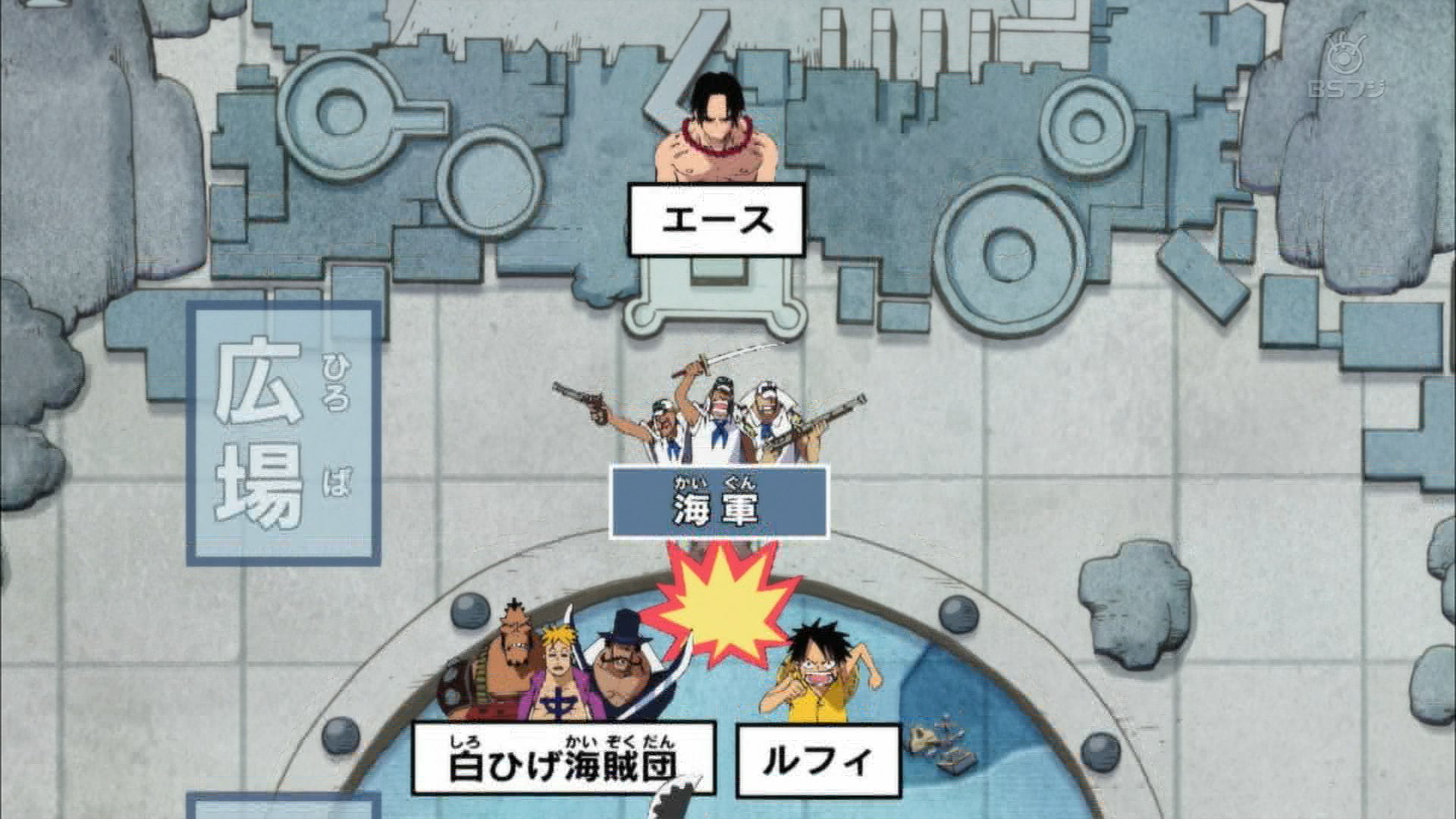

    I have a good amount of experience encoding DVDs and BDs, but I never apply any kind of filtering to the video. My goal is to try to encode something that looks as close to the source as possible, and I feel like I accomplish this fairly well after having done many encodes.
    Now I'm venturing into new territory. I want to encode some anime transport streams taken from Japanese television, but the streams I have found look terrible. For the most part, they look fine, but... well take a look.
Name:	ワンピース 第470話 「剣豪ミホーク ルフィに迫る黒刀の斬撃」 (BS-FUJI) [.jpg
Name:	ワンピース 第477話 「命を削る力 テンション・ホルモン再び」 (BS-FUJI) [.jpg
    I'll admit that I don't know much about tv capture or anything like that. I'm just getting these off the internet, so I have no control over the source. I have seen encodes of these episodes from fansub groups that look perfectly fine.
    My question is would a different capture of the same program look different? Is that how fansub groups make their encodes look good? Do they just start off with a superior transport stream compared to what I can find randomly on the internet?
  2. Those are DCT ringing and blocking artifacts from too much compression. And probably a few generations of re-compression. Others are probably starting with cleaner sources.
