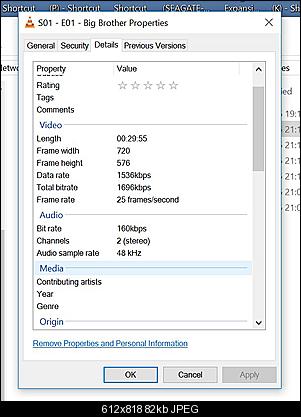

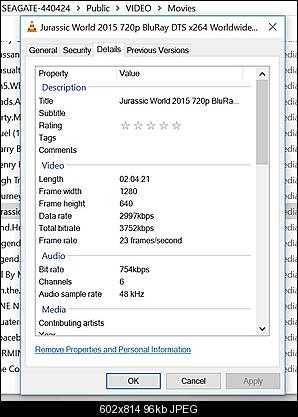

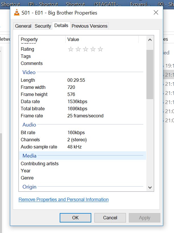

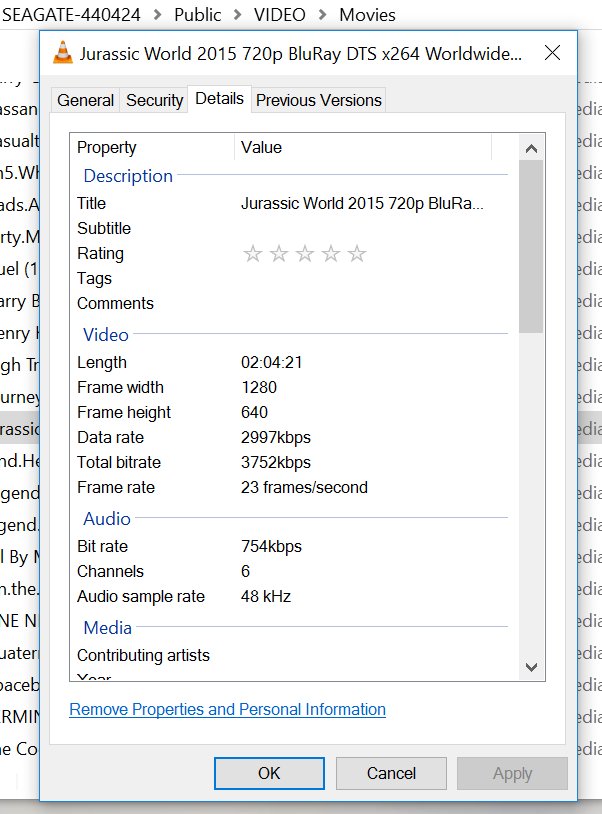

    Thanks for the replies Both files play without issue on a memory stick or DVD Media, below is a screen grab of the properties of the two examples, the first is a 3.4GB file of a 5.1 DTS movie which can drop out or freeze, and the second a 350MB Sitcom download, which runs fine. Apologies for the size of the images, Im afraid im a bit nieve when it comes to bitrates and video streaming etc etc.

    Bit rate is not excessive, but 23 fps is not common
