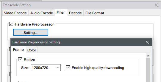

  16. I see what you mean with the input. Using hardware downscaling with high quality looks great though.

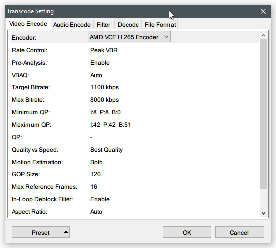

    In A's I must the GOP very high to get a quiet image to obtain without keyframe bumping (and does not always work)
    Examples with source (in A's the GOP is "Auto") same settings...
    Regards
  18. Your hybrid example pumps too, just at longer intervals. A larger GOP is being used. This was established on page 1 of this thread months ago, use a larger GOP

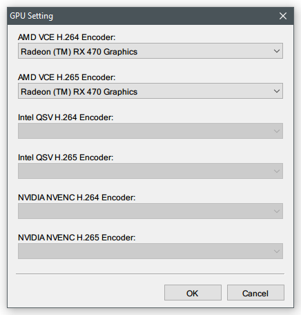

    For A's convertor you must select your GPU:
    Then you can select AMD VCE H265 encoder from the dropdown:

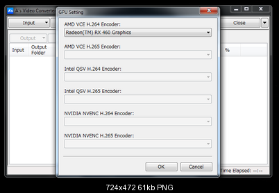

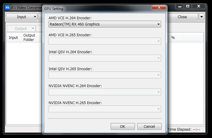

    Yeah, the H.265 part is grayed out. I just uninstalled A's and installed the newest 7.0.1 with same result in the picture. I've had this problem during all of the A's 7 beta. I am also running 17.1.2 Radeon Drivers on Windows7, with a 2GB RX460.
    Thanks for the OBS info.
  20. Don't know then, maybe you need to upgrade to windows 10? A's uses microsoft's media foundation framework, which was updated for HEVC in windows 10. I don't know if you can use HEVC (even third party) through it in Windows 7?
  21. Dinosaur Supervisor KarMa's Avatar
    Jul 2015
    US
    Well HEVC works in AMD Relive.
  22. ReLive uses AMD's own AMF framework, not MFT like A's does.
    The OBS plugin also uses AMF so you should be able to use HEVC through that too.
