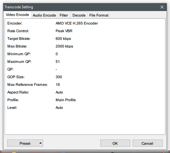

  5. Apparently RTMP doesn't support HEVC, so that's impossible. When I do stream I use H.264, but with OBS & the VCE plugin you can squeeze more quality out for a given bitrate than you'll get from ReLive.
    I enable CABAC, use VBR with a higher peak, 16 reference frames, extended GOP, pre-analysis pass and so on. It allows for perfectly acceptable 720p30 video in twitch's 3500kbit/s soft-limit. I prefer to do 720p60 at around 5-6mbit/s instead though, using hitbox (Attached example).

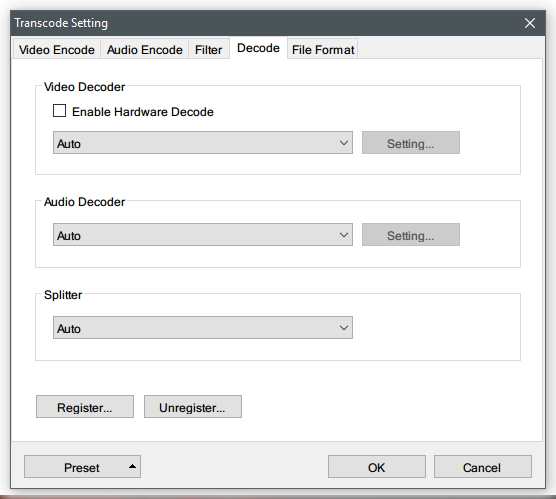

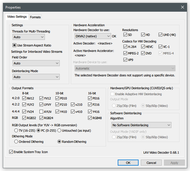

  11. Make sure you have the latest ReLive drivers installed. Also make sure you have up to date LAV filters installed.
    In A's disable its hardware decoding (seems flaky to me):
    A's will use LAV to decode pretty much everything as a result. And you can configure LAV to hardware decode:
    If LAV can't hardware decode it will fall back to software. Likewise, on the filters tab I prefer the software filters. HW seems to impact encode performance negatively. Here are settings I use for 960x540 HEVC:
    Lastly, using A's internal muxer which produces .mp4 files results in issues when seeking through the files. Both VLC and MPC-HC both end up with grey blocky messes. You can fix this by selecting MKV, and giving A's the path to mkvmerge:
    Doing all this, I get nice (enough) quality small 960x540 HEVC videos from A's, that are seekable Obviously change the bitrates and filters (if any) to suit your desired resolution / quality.

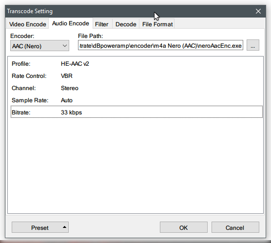

    As a final note, I like to use the nero AAC codec to utilize HE-AAC v2. You can pick nero on the audio encode tab and give it the path to neroAacEnc.exe. HE-AACv2 at 33kbit/s sounds fine.
