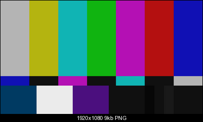

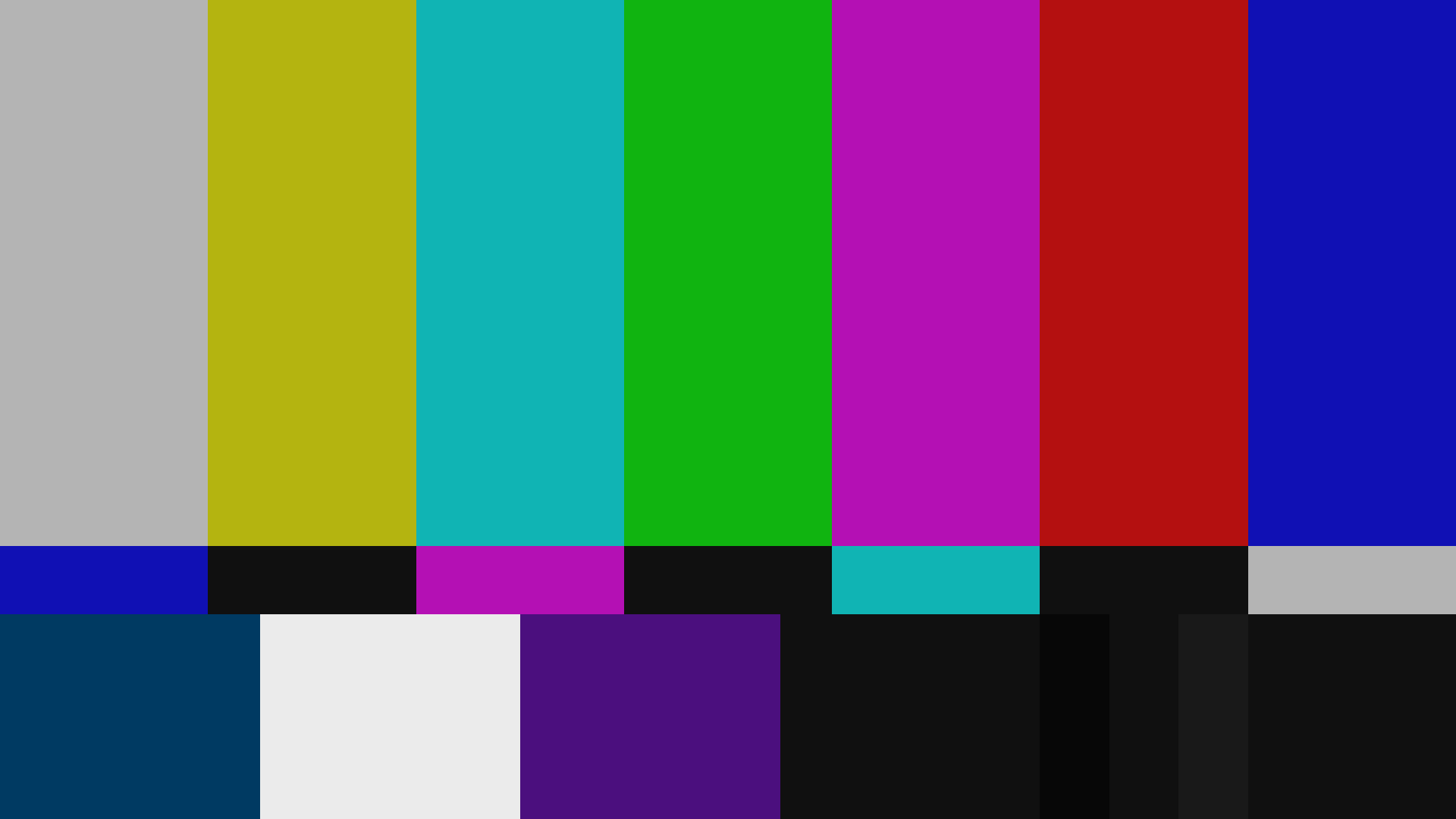

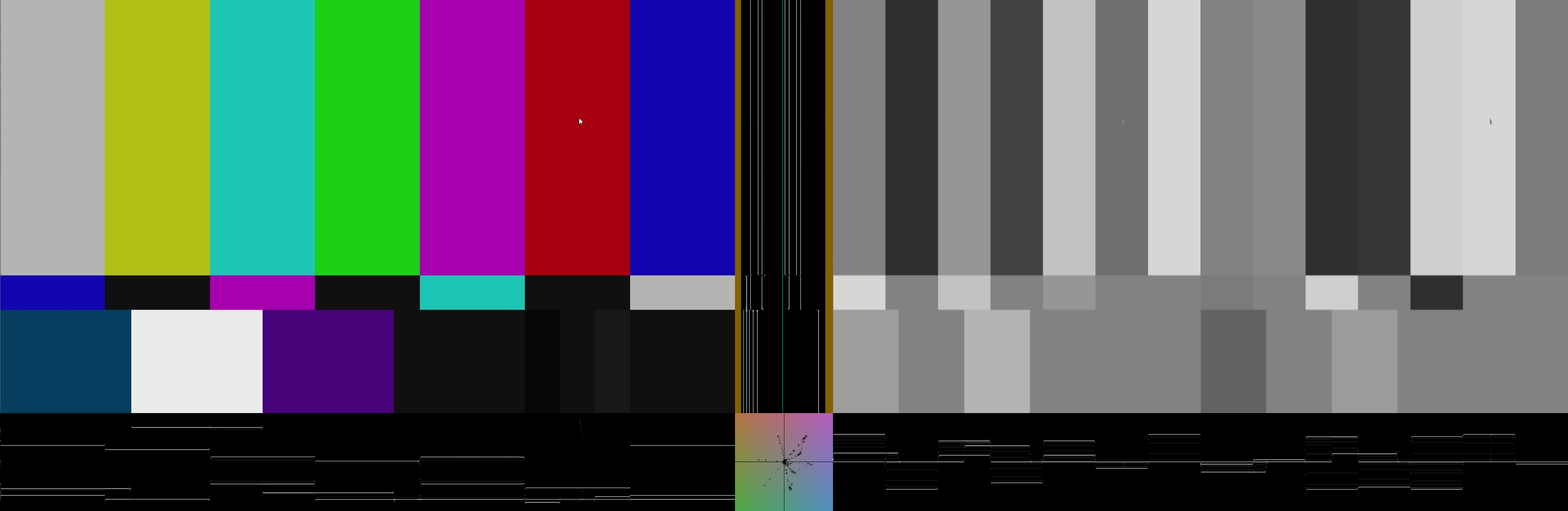

    To show what I mean by the color shifting I'm noticing, I made a simple RGB32 colorbars in avisynth with colorbars(width=1920, height=1080), to simulate a standard RGB screen capture (video game for example). My card is outputing RGB32 and I only managed to save the test bars as a RGB24 .PNG but that should not matter too much. With the generated colorbar sample I made it my desktop background and then proceeded to capture video of my desktop with both OBS Studio and AMD's ReLive software. With the two programs, I captured in YUV 4:2:0 (NV12), as well as H.264/60fps/20Mbit. Which should be plenty of bitrate for stationary color bars.
    To help with comparing the two captures I used AlignExplode() from vaporeon800. The script requires a YUY2 input so everything gets converttoyuy2() before AlignExplode().
    The .PNG testbars I created and eventually set as my desktop.
    What it looks importing the .PNG into avisynth for alighnexplode(). The conversion to YUY2 does not seem to have hurt it much.
    ImageSource("C:\....\ColorBars.png")
    converttoyuy2()
    AlignExplode()

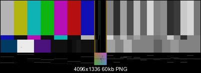

    What the OBS capture of my desktop looks like, with expected RGB->YUV420 chroma resolution loss. But no obvious color shift. (OBS settings used 601/Partial range)
    LoadCPlugin("C:\......\ffms2.dll")
    FFVideoSource("C:\.........\OBS.YUV420.mkv", threads=1)
    converttoyuy2()
    AlignExplode()

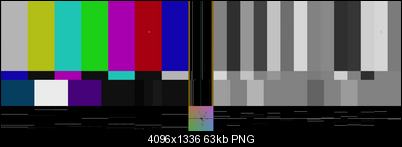

    AMD's ReLive capture of my desktop to YUV420, giving the expected 420 chroma loss along with a major color shift. Using ReLive's default YUV settings, as the user can not configure anything with the YUV output settings. All I know is that ReLive outputs YUV420, with both the H.264 and HEVC options.
    LoadCPlugin("C:\.....\ffms2.dll")
    FFVideoSource("C:\........\ReLive.YUV420.mp4", threads=1)
    converttoyuy2()
    AlignExplode()
    I could have overlooked something as I'm sure there are still things for me to learn on RGB-YUV relations, so speak up if anyone sees an issue with my testing methods.

  10. Originally Posted by KarMa View Post
    Your ReLive capture is using the wrong color matrix, rec.601 instead of rec.709. Using:
    ImageSource("RGB-YUV.ReLive.png") # RGB image
    ConvertToYV12(matrix="rec601")
    ConvertToRGB(matrix="rec709")
    restores the original colors (aside from rounding errors).

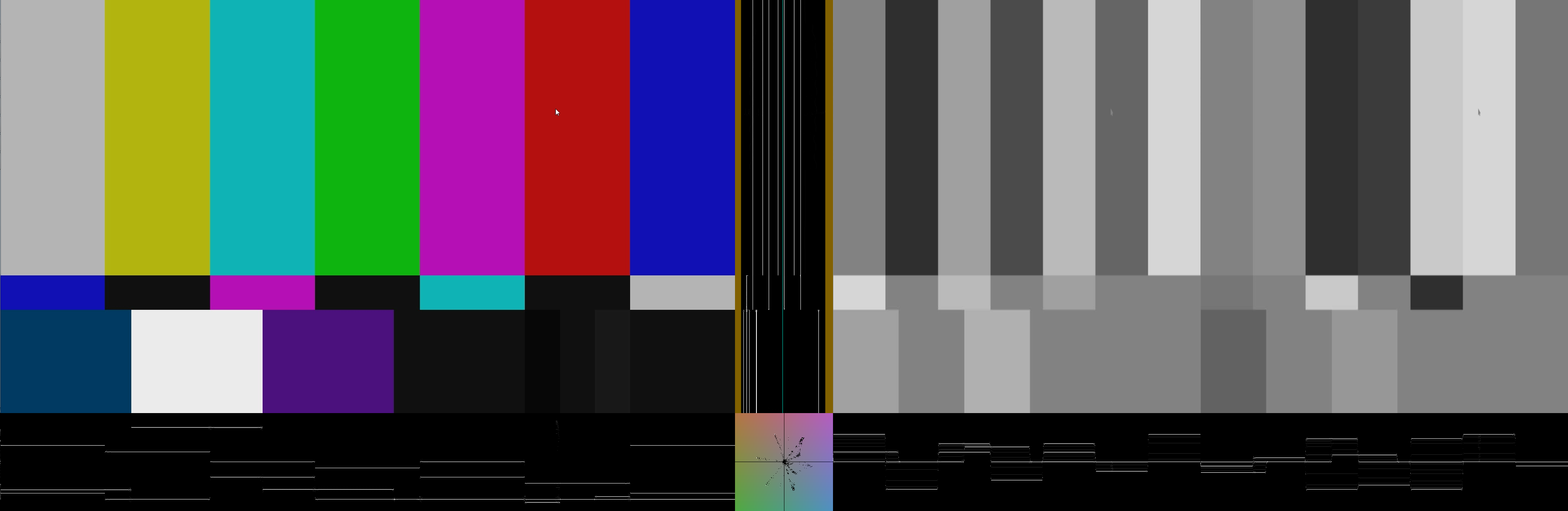

    FFVideoSource("C:\...........\ReLive.YUV420.mp4", threads=1)
    convertToRGB(matrix="rec709")
    converttoyuy2()
    AlignExplode()
    Yeah that fixes it jagabo, just has the added loss from another RGB-YUV conversion as you said.

  14. How are you producing those images from AlignExplode? The output of that filter is YUY2 video so it's being converted by some program to RGB before you can save the image as PNG. VirtualDub, for example, usually converts YUV to RGB with a rec.601 matrix -- regardless of resolution, even if the video is flagged rec.709.
    Maybe you should just upload short video samples for analysis.
  15. Dinosaur Supervisor KarMa's Avatar
    Jul 2015
    US
    Using AvsPmod to deal with the avisynth and using it to output PNG snapshots. All of the .PNGs I have uploaded on page 3 of this thread have been saved with AvsPmod, including the original 1080p colorbar picture. Ok I'll upload video samples.
  16. You can control the final YUV to RGB conversion by adding ConvertToRGB(matrix="rec601") or rec709 at the end of your script. That way you know for sure how it was done.
    Also, I misinterpreted the situation in post #70. It looks like the ReLive is using a rec.709 matrix to convert captured screen RGB to YUV in the video -- which is typical for HD video. AVSPMod is displaying it wrong, using a rec.601 matrix.

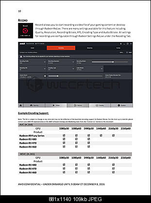

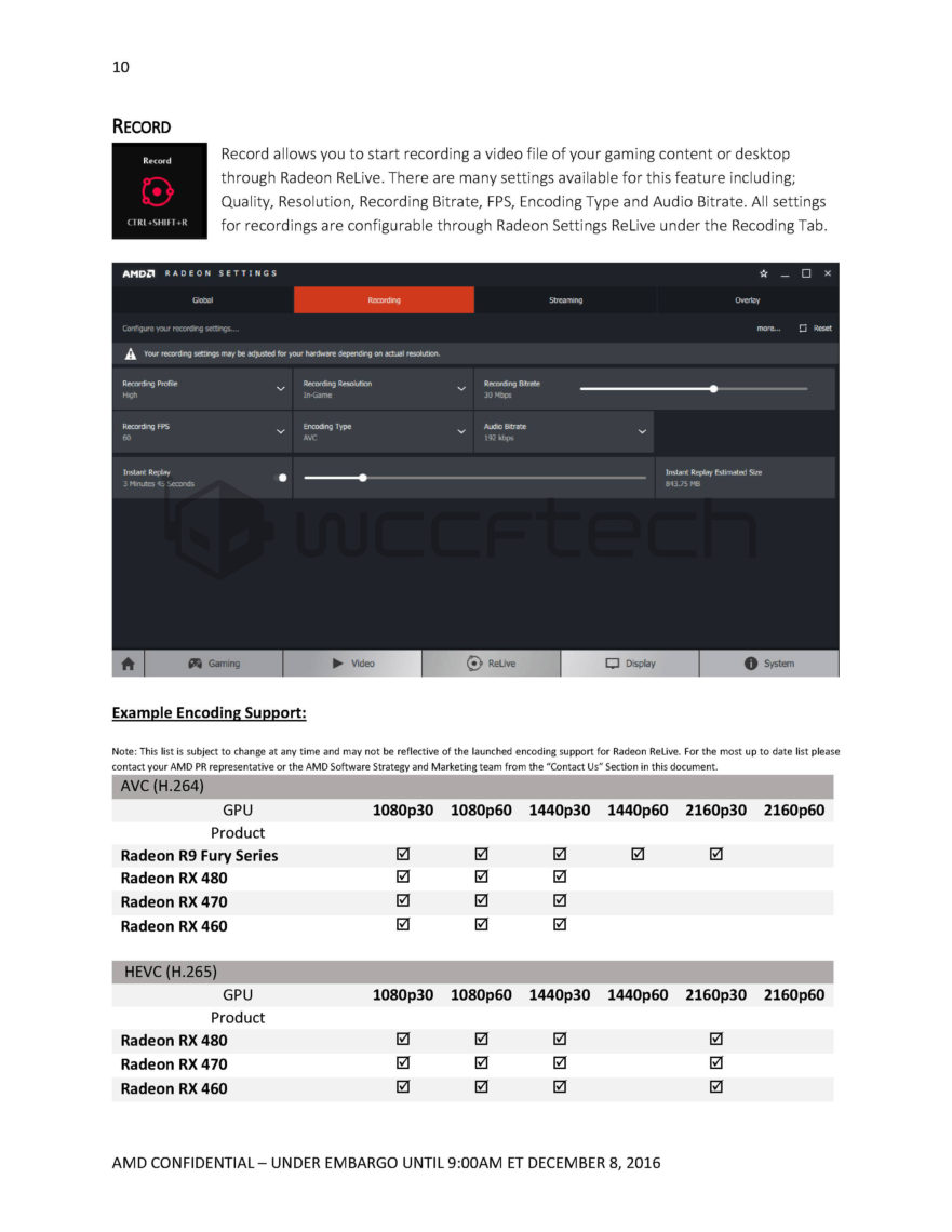

  21. Just found out that rx 480 will not support 4k60 encoding, that has me leaning towards Nvidia:
    http://cdn.wccftech.com/wp-content/uploads/2016/12/file-page10-copy-881x1140.jpg
Name:	Rx _460 encoding.jpg
  22. AMD's poor track record with video encoding should be enough to sway you away from them.
  23. Originally Posted by jagabo View Post
    The quality is very good, if I didn't need the 4k, I'd be more than happy with it. The HEVC encoding quality on the Polaris cards is very, very good.
  24. That slide you linked pertains to AMD's relive tool's encoding, VCE's capabilities are higher. If you click each version of VCE here you can see benchmark results.
    Albeit for H.264, but polaris encodes H.265 faster than it does H.264, I guess they designed it with the future in mind.

  30. Originally Posted by Roph View Post
    Wow those numbers are not good, especially at the quality setting, it can't even do 1080p60 in real-time. The reLive samples look ok, but the A's converter samples are more pertinent to the capability of the card.
    But overall, I'd say AMD has done a great job at the sub $100 price range and they will only improve with vega
