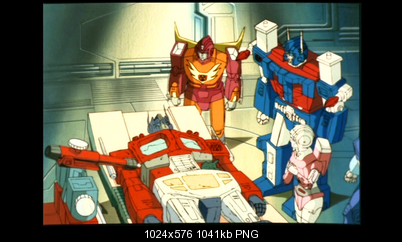

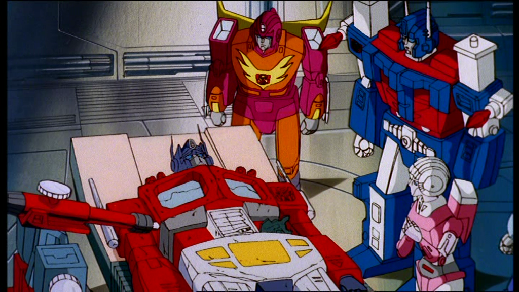

    The following complete image is 1024x576 with an aspect ratio of 16:9 and the section in the blue box is a central 4:3 cutout at 720x576.
    What's the ratio of the whole actual image (minus the black bars - you can leave a few pixels of them on either side if it means you get a known standard ratio)?
    Is it 14:9? And what would the resolution be in this case?

  2. Originally Posted by bergqvistjl View Post
    ...the section in the blue box is a central 4:3 cutout at 720x576.
    If it's 720x576 then it's not 4:3 but 1.25:1. Anyway, what's the source of this image? Did you create it? Have you satisfied yourself that it's in the correct aspect ratio (round things are really round and not ovals)? Just cropping the black away leaves an aspect ratio of about 1.4:1 so something is probably off.
    My guess is it's from a 4:3 source, with the black bars added for some reason.

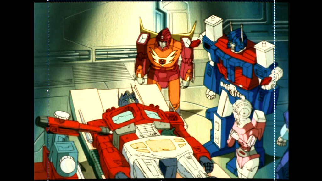

    Crop(108,0,-108,0)
    Lanczosresize(768,576)

    More detail about the source would help narrowing down the cause.
    My first idea was, someone took an NTSC DVD (720x480) and put it in a square pixel 16:9 frame without accounting for the rectangular DVD pixels. Upon close inspection that does not seem to be the case as after cropping to the 1.5:1 SAR of 720x480 the remaining black borders at the sides are still much thicker than what you would typically see on a DVD source picture.
    If we just cut the sides (left and right only) we are left with about 808x576. That's 1.40:1. So it's not 14:9 either. More like someone slightly zoomed a 4:3 frame to make the pillarboxing smaller, but then why is there still some borders left at the top and bottom? Sounds like an error to me.

    It is from a 16:9 anamorphic PAL DVD. The source is from footage which was wider than 4:3 yet not as wide for true 16:9
    It's from the PAL Transformers The Movie: Reconstructed DVD. It's the raw animation frame (which would normally be cropped to 4:3 for actual release), which explains why the image itself is wider than 4:3.
    I added the 4:3 blue-border myself, so it may not be accurate. The original screencapture was from the DVD, which (as its anamorphic) i've stretched horizontally to get the correct aspect.
    Here is the original raw frame from the DVD if you want to ignore my attempt & creating a 4:3 cut-out & try again:

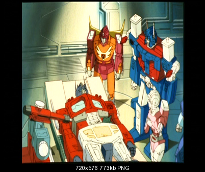

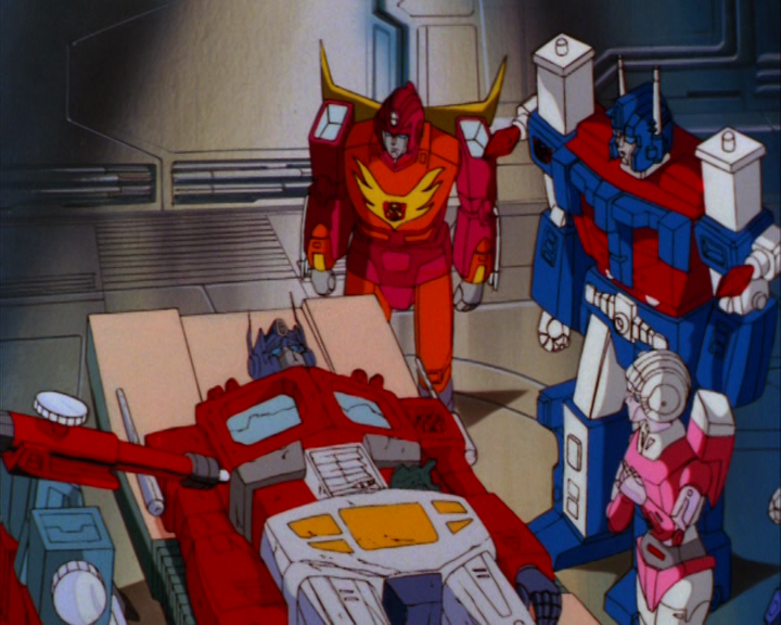

    The black bars either side are part of the image as it is on disc. All i've done is stretch it because it's anamorphic. Here's the original without stretching (the above stretched version is the correct one):
Name:	Transformers ORIG43.png
    Basically, the animation frame you see above would have been matted slightly to create a 4:3 transfer (and matted further for 16:9 transfers) for theatrical or previous home video relases. With this release, they've removed the mattes to show the full animation frame. This is how that full frame was presented on disc. I'm trying to work out the ratio of what that full frame would be (and if the vertical resolution is still 576, what the horizontal resolution would be for that ratio).
    Just to make things easier, i'd like the ratio to be worked out without cropping off the tiny black bars top & bottom - so working it out from the full height of 576).
    Ultimately i'd like to know if the ratio of the full frame conforms to any known standard (e.g. a standard animation cell size for the mid 80s)?

    2006 - UK 'Ultimate' edition - Disc 1 - 16:9 transfer of the US version of the film (although this looks stretched to me, but it's supposed to be presented 16:9)
Name:	2006 UK Ultimate Edition Disc 1.png

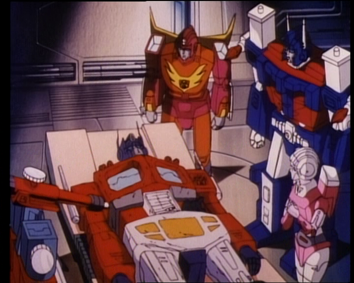

    2006 - UK 'Ultimate' edition - Disc 2 - 4:3 transfer of the UK version of the film
Name:	2006 UK Ultimate Edition Disc 2.png
    2006 - US '20th Anniversary' edition - Disc 2 - 4:3 transfer fo the US version of the film
Name:	2006 US 20th Anniversary Disc 2.png

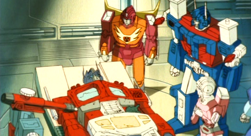

    Interestingly, if you want ANOTHER perspective, take the 2nd of my images (the non-anamorphic Reconstructed version), and stretch the image out at each side so the black bars are replaced and the image is now taking up the whole 720x576 canvas: It suddenly looks in better proportions than the anamorphic 16:9 one (to my eyes)... http://screenshotcomparison.com/comparison/181718

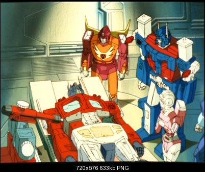

Name:	2005 UK Reconstructed_CORRECTED.png

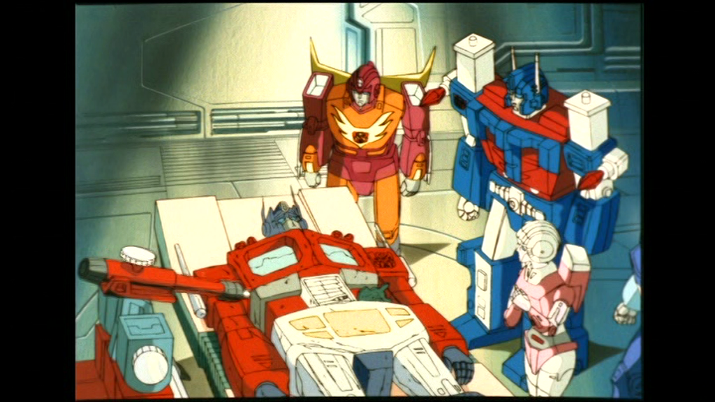

    Again the question is what is your final goal? Theatrically it would appear something like this:

  20. Originally Posted by bergqvistjl View Post
    My goal was basically to work out what the ratio of the animation frame was, but I think that's hampered by the fact that it looks to me like even the 'reconstructed' version, for that shot at least, has been stretched incorrectly anyway (comparing it with the US 4:3 one).
    Apparently, the real aspect ratio is 1.4:1. And it's correct, even though it was never intended to be viewed at that aspect ratio. For that and for other reasons as discussed in the DVDTalk review linked above, this is probably the worst DVD ever made of that film.
