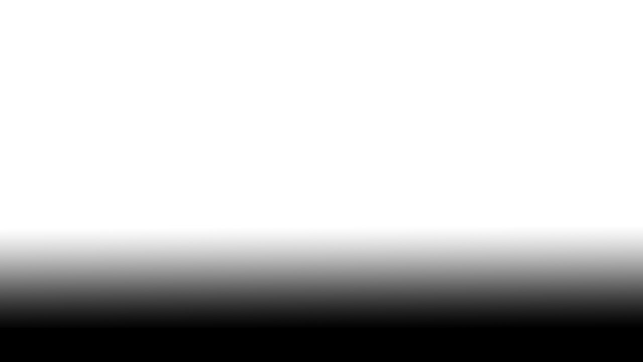

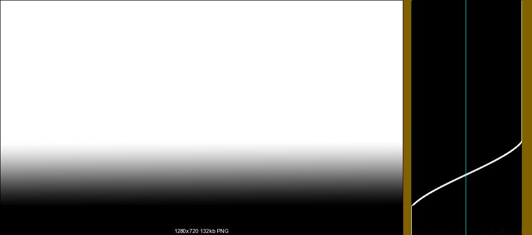

  7. Further to my posts above, i have discovered that in certain cases - where the masks involved are not 'pure' 0-255 black and whites, then using a RGB32 conversion does help to overcome one problem I've encountered.
    I made a overlay mix of a 'clean' and 'blurred' version of a seascape, to create a shallow depth of field illusion (in focus in the foreground, out of focus in the background). To achieve this, I used a 'graduated' mask (sample attached). It seems to work quite well - except that the resulting video clip is not completely opaque.
    The effect is that when using the new 'mixed' clip to overlay another seascape which has intrusive elements I want to cover, then using a #000000 mask does not completely mask out those features in the underlying clip.
    However, if I convert the clips involved to RGB32 and use 'Layer', the situation is much improved (although probably still not perfect - difficult to tell)
    So, as Jagabo quite rightly points out, not making the masks correctly with pure #000000 and #FFFFFF can cause problems...
    Despite introducing some colourspace conversion loss of course, the RGB conversion helps in the case of 'bleed though', when using grey scale graduated masks to mix or 'morph' two clips.........

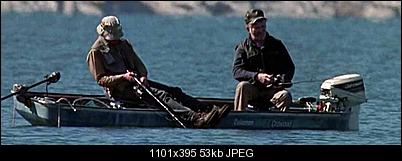

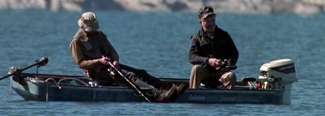

  9. The project in question is to modify a short section of the intro to a famous old movie - "Always" - by removing the fishermen from the sequence... it's just to create a clean source for a fun 'spoof' version of the famous clip....
    To illustrate the problem I encountered, I've attached a couple of frames and short clips..
    This frame from the original source shows the fishermen - note the 'bright' dangling fishing rod, the right shoulder of that same guy, plus the right trouser (sorry pants) leg of the second guy;

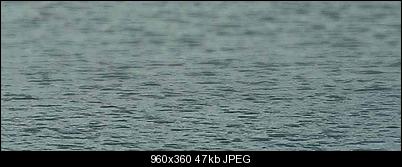

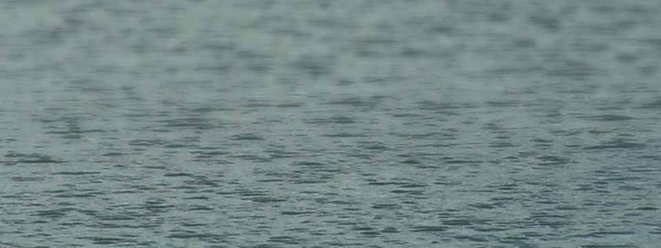

    The 'mixed focus' sea overlay was created by applying the mask in my post #7 above to 2 clips -- one of an in focus seascape, and one of a 'box blurred' version of the same clip. It is this mask which seems to allow some transparency of the final clip?.. There is a sample image from that clip here:
    When I then overlay the mixed sea clip over the original source, using a 0-255 black and white mask, the resultant clip appears to allow some 'bleed through' of the original source. All the clips were created using Grass Valley HQX as a working intermediate format.
    You can still see the bright 'dangling' fishing rod and that guy's right shoulder quite clearly in the attached 'demoYUV' clip. You can also (just)see the other guys right leg as well........ I'm guessing all of the part of the image that falls within the 'grey' area of the sea mix mask will be a little bit transparent?

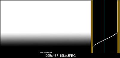

  12. Here's a histogram of your mask converted to YUY2 with ConvertToYUY2():

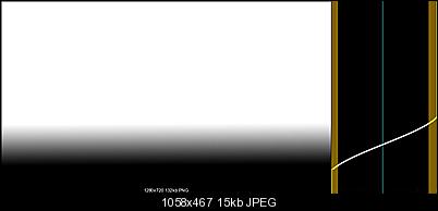

    This is the standard way of converting RGB to YUV, most programs will do it like this. Here's the same mask converted to YUY2 with ConvertToYUY2(matrix="PC.601") to be used as a mask for Overlay():
    Notice how the blacks now reach all the way to zero and the whites all the way to 255.

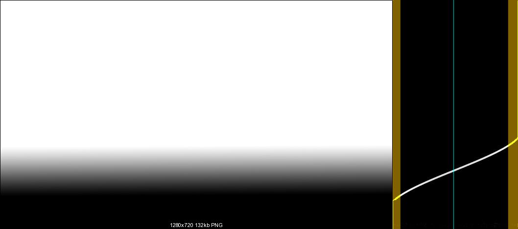

  14. I've created a new mask by inputting my full range black and white pngs into Vdub, and exporting as a Lagarith RGB file. Using the ConvertToYUY2(matrix="PC.601") instruction I can create a full range mask using my usual HQX codec which, as you have advised, solves the problem completely.
    I had convinced myself that it was my graduated 'sea mix' mask that was creating the problem only in the centre of the image. Wrong.
    It was - as you say - the 16-235 range of my YUY2 main mask that was the problem
