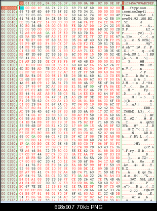

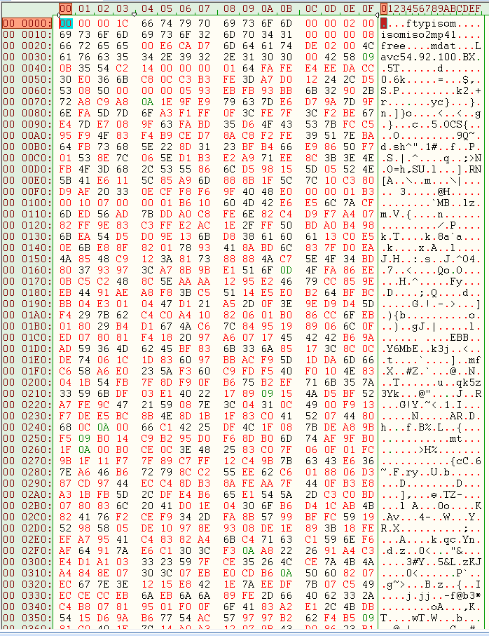

    The hex code for the file looks like this, was wondering if anyone here would be able to identify a broken header or something:
    Anyone have any suggestions? I have also tried re-downloading the email attachment 3 times, through 2 different browsers; same result
    I really need to be able to see what this video contains so if anyone is able to help, it would be most appreciated.

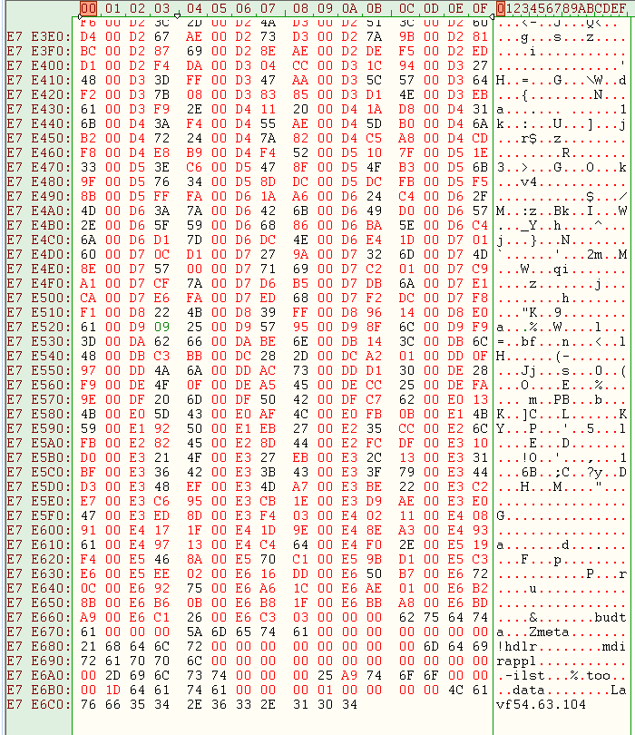

  2. Also, here is the end of the hex code, incase there is something meaningful there:

    That's a video from some sort of phone that does variable frame rate I believe. Posting/knowing the HEX data is probably not going to help.....the complete MediaInfo data would provide more info.

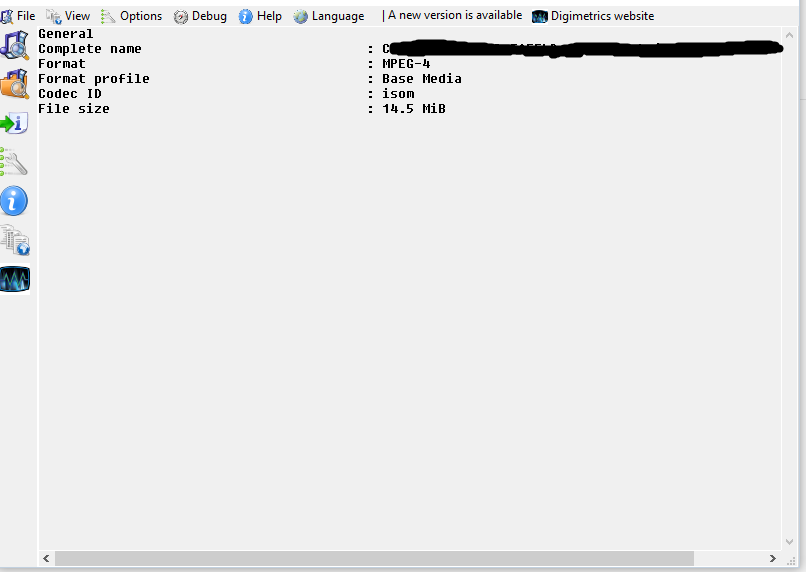

    Yeah, I know... This is all I get:

  7. Looks like corrupt file, there should be more details

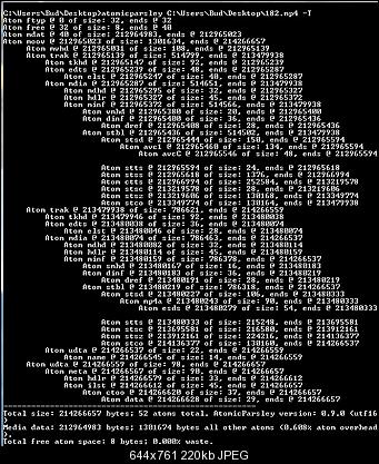

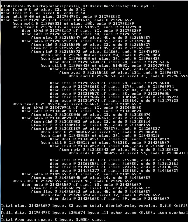

    You might try 'AtomicParsley' and see what it tells you about the structure. Go to CMD screen and type:
    "c:\pathToAtomicParley\AtomicParsley.exe" "C:\pathToVideo\VideoName.MP4 -T"
    You will get error msgs or a display similar to the following:
