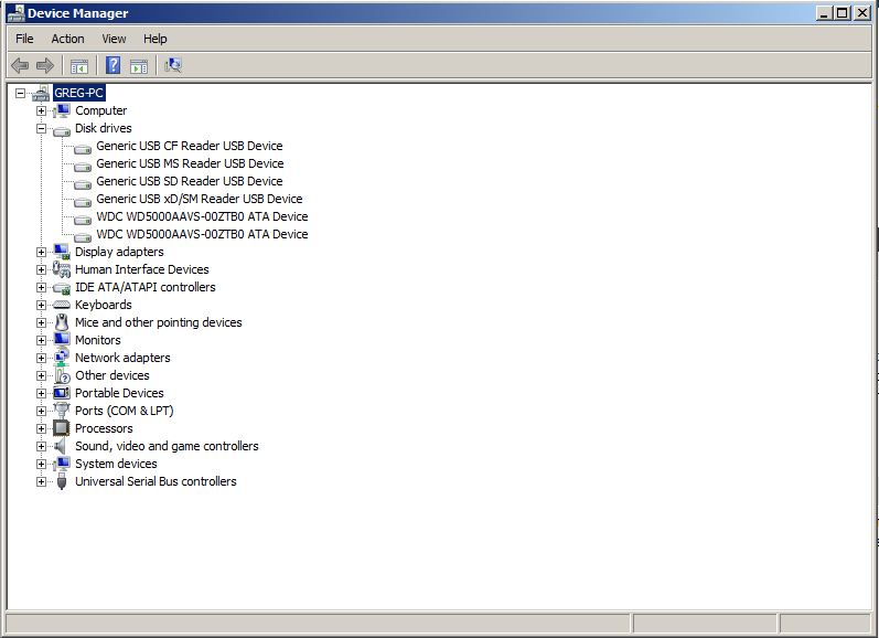

    Try right clicking on my computer - select properties - hardware - device manager,
    Click on CD/DVD drives, click on your drive and go to driver and click Uninstall
    Restart computer and let windows reinstall the drive.

    Theres no cd/dvd drives
