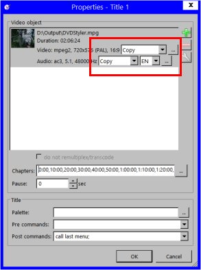

  8. As I understand you want to use some material from the two DVDs and use that to author a new DVD. Then
    - Use MakeMKV to extract Titles.
    - Should you need the material on chapter level use MKVToolNix to extract chapters.
    - Author with DVDStyler and make further cuts if needed.
    This is all without re-encode. I think you misunderstand the transcode/re-encode in DVDStyler. When DVDStyler shows "Copy" on the property sheets as shown below no re-encode is done. The box "Do not remultiplex/transcode" may be greyed out as a remultiplex is needed but that's not a re-encode.
