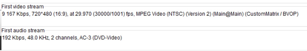

    if the vob files look like that in media info https://forum.videohelp.com/images/imgfiles/3wJzdeH.jpg
    telling me 29.970 fps and NTSC is it safe to assume that "TFM().TDecimate(Mode=1)" would be the best approach ?
  9. Originally Posted by zanzar View Post
    That tells no one anything remotely useful. The only way to tell how you should deal with a video is with your eyes. Make your script with MPEG2Source and no other filters and start looking around. Sometimes, to learn more, put on a fast bobber like Yadif(Mode=1) to examine the fields more closely. After you have a look at different parts, only then decide if it can and should be IVTC'd, unblended, bobbed, left alone, or what.

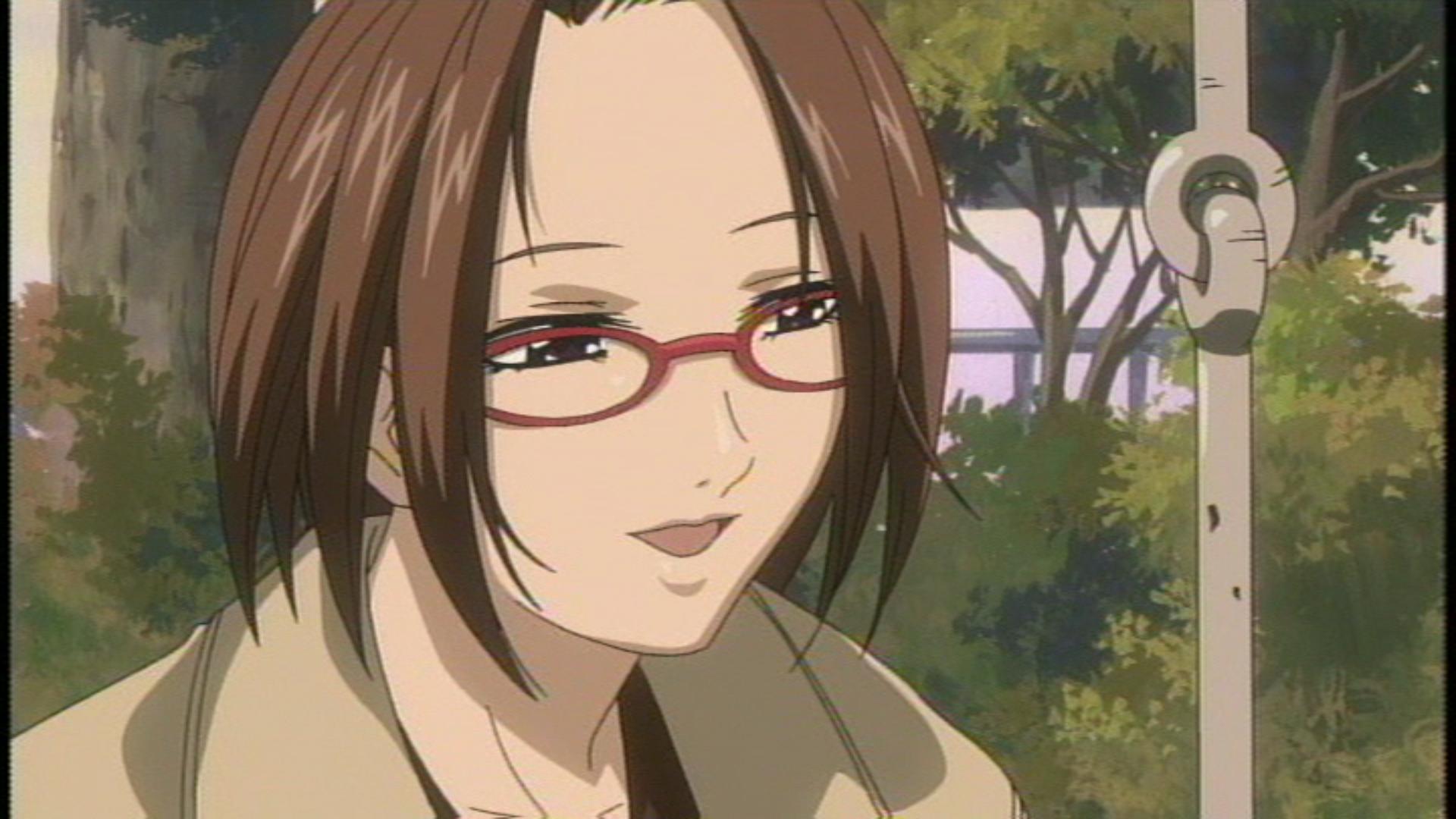

    i have a rip i downloaded called "name+ [Raw] (DVD 708x480 x264 Hi10p AAC)"
    i dont know why but he didnt crop the black bars , maybe intentionally (also i removed ColorYUV and Crop from your script so it would be easier to compare)
    his rip looks very natural and has a small size but with good quality despite low bit rate
    Original
    With Your Script
    Other Rip
    if you zoom a bit you can see that the last one has the finest detail

  17. Originally Posted by zanzar View Post
    You and I have very different opinions on what constitutes detail.
    Most people are looking for more sharpness when they upscale, that's why I sharpened a bit. If you want less sharpeness remove the aWarpSharp() and Sharpen() filters. And use a less sharp resize like BilinearResize(). If you want more noise reduction use higher settings in TemporalDegrain(). Or use QTGMC(InputType=1, EZDenoise=2.0) or something like that and blur away all the detail in the bushes, etc.
  18. Originally Posted by jagabo View Post
    so just play with the filters until i get the result i want?
  19. Originally Posted by zanzar View Post
    Well, duh!
  20. Originally Posted by jagabo View Post
    Well, duh!
    what are those "Encoding settings" in the spread sheet i posted ? looks complicated ...
    also any idea what filter will give me this "shadow around lines affect" ?
    one with the noise is the original DVDISO and the other is an "480p,DVD,x264-Hi10P,AC3" version some one made
    http://screenshotcomparison.com/comparison/181493
  21. Originally Posted by zanzar View Post
    Spreadsheet? You mean the MediaInfo report? Those are the placebo preset plus the tuning for animation. The x264 command line would be:
    x264 --preset=placebo --tune=animation --crf=18 --output output.mp4 input.ext
    I'm not sure what you mean. Are you referring to the oversharpening halos around all the black lines and other high contrast edges? Those are from sharpening the video before scaling. Your source DVD was made from an analog tape recording. Analog tape players often apply a sharpening filter (because of the inherently low resolution of tape) that creates those halos. You usually want to avoid those, not create or accentuate them. They are not part of the original picture.
  22. Originally Posted by jagabo View Post
    i just play the DVD with mpchc with lav filters and mild madVR settings so i dont think there are much sharpening
    so its a comparison with the DVDISO played trough MPCHC and some MKV rip with some ones filter settings.
    do i use DeHalo alpha to fix this over sharpness?
    you can zoom out to see the bigger picture (its zoomed in on default)
    i am sorry if i am not talking with you on the same level i just dont know some of the terms you are using some times
    thanks
