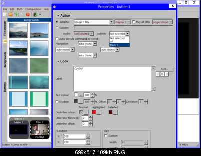

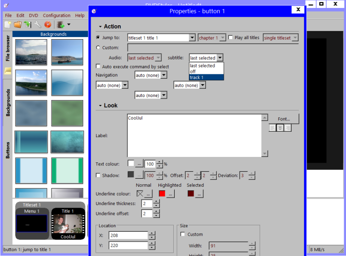

  3. Avs2dvd does not offer a subtitles menu option
    Or you could use DVDStyler.
    Just know you should have the button on a VTSM (Titleset) menu and not a VMGM menu.

    Well, it crashed the first time I used it, but now I've gotten it pretty well figured out and it has not crashed again. If I have any further questions, hopefully its support thread can help me.
