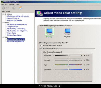

  8. Check your video card settings for any video enhancing options. They would effect MPC-HC but probably not VLC as it doesn't use a Windows renderer and it'd have nothing to do with decoding quality as such.

  9. i have nvidia geforce GT610 Asus
    its brand new & came with no fan
    where could i find video card settings for any video enhancing options?
    thanks

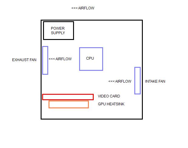

  13. Mod Neophyte redwudz's Avatar
    USA
    My GT610 has a sufficient heatsink for my uses. I did mount a 80mm fan below the card to blow a bit of air at the heatsink, but it's a very quiet fan.
    Here's an example of a quiet fan that is suited for GPU cooling: http://www.newegg.com/Product/Product.aspx?Item=9SIA2W03YJ8791&cm_re=case_fans-_-11-99...-199-_-Product
    14DBA noise level, so very quiet. Not much air, but you don't need a lot most times. You would probably need to fabricate a bracket from some scrap metal to mount it underneath the video card. Just a suggestion. Hopefully your motherboard has a unused fan header. If not, you can use a power adapter from a hard drive socket. Some fans come with them.
    In general for good case cooling, you need to seal up all unnecessary holes in the case. You want a unimpeded flow of air, usually from front to back.
    You can see in my diagram that the GPU heatsink is often mounted below the airflow, so poor cooling. And even worse, the heatsink is usually on the bottom of the card. Since heat rises, a really poor position for heat dissipation.
    I haven't really made any adjustments on the video card settings, it performs well at default settings. It's fine for HD video, which I send to my monitor and to a projector via HDMI, but it's not a gaming card. For fast gaming, you need a expensive card. I don't game.

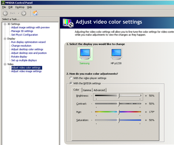

    If you're using Asus drivers I'm not sure, but for Nvidia drivers there should be a Nvidia Control Panel shortcut in the Windows Control Panel, or whatever the old Control Panel is called these days (I'm still using XP). Maybe under display settings or something like that for Win7. It'll look something like the pic below. The video specific settings only effect video, not Windows in general, and only for DirectShow players such as MPC-HC, as far as I know. I don't think they'll have any effect on the video VLC displays. If you have Asus drivers installed there might be an Asus version of the control panel.
    MPC-HC has some basic picture adjusting settings of it's own under Options/Miscellaneous. If the video card is configured to adjust the picture the MPC-HC settings probably won't work. It's usually one or the other.
