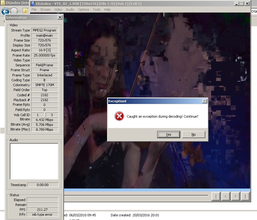

  1. Hi. I've just bought a DVD of a 2009 concert by a German singer. It would be logical to expect such a DVD to be 'progessive', wouldn't it?
    According to mediainfo, it's interlaced and DGIndex says that too. During the scan, DGIndex kept throwing me a warning about 'caught an exception' (see pic). What does that mean exactly?
    As hech54 said, decrypt it properly. I wasn't quite clear on how you did decrypt it but I wouldn't think Handbrake should be used for that.

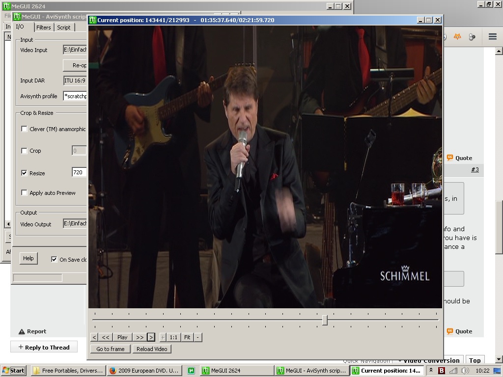

  4. Thank you, both. I've installed DVD Decrypter and used it to make a single VOB of my DVD. To make the D2V file, I used MEGUI which also allowed me to go through it frame by frame so there was no need for avidemux.
    As it's concert footage, there's not much in the way of 'car chase' style movement but I think this snap confirms the DVD to be interlaced!
    I didn't know that virtually all PAL DVDs are encoded as interlaced. I just assumed that progressive, being a 'true' image, would be used by modern production companies.
