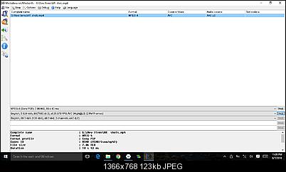

    Ok, I got MediaInfo downloaded and running and got a screenshot of the information about a 10 second video I made from a longer one. It started out as an .avi video and I edited it using PowerDirector12 and saved the result as an MP4 file. The video now has no audio no matter what I play it back on. Here is the screenshot showing the MediaInfo information. Can you tell me from this why there is no audio?:

    According to what you provided, it does have audio. The codec used, and the audio specs are shown in the screen above.
    And I assume the source AVI files plays properly? In which case, check the audio config in PowerDirector12.

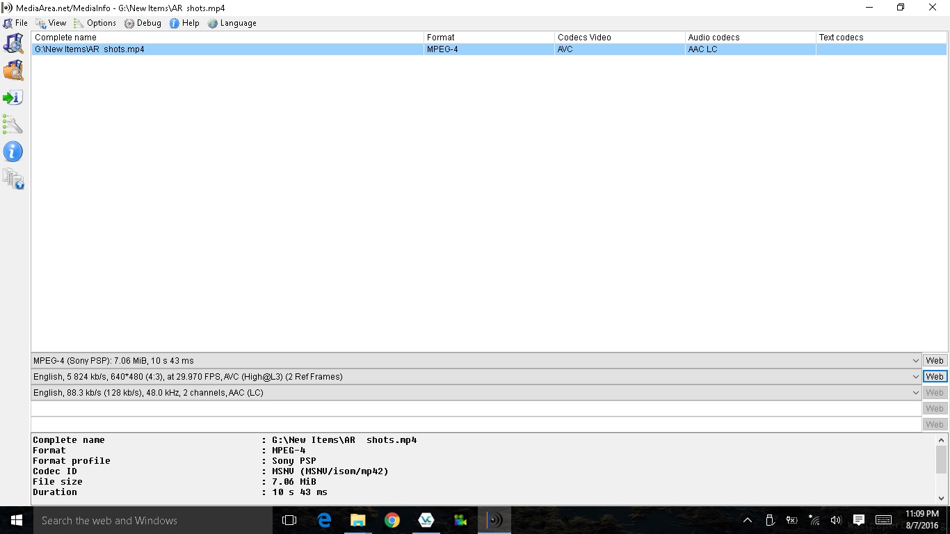

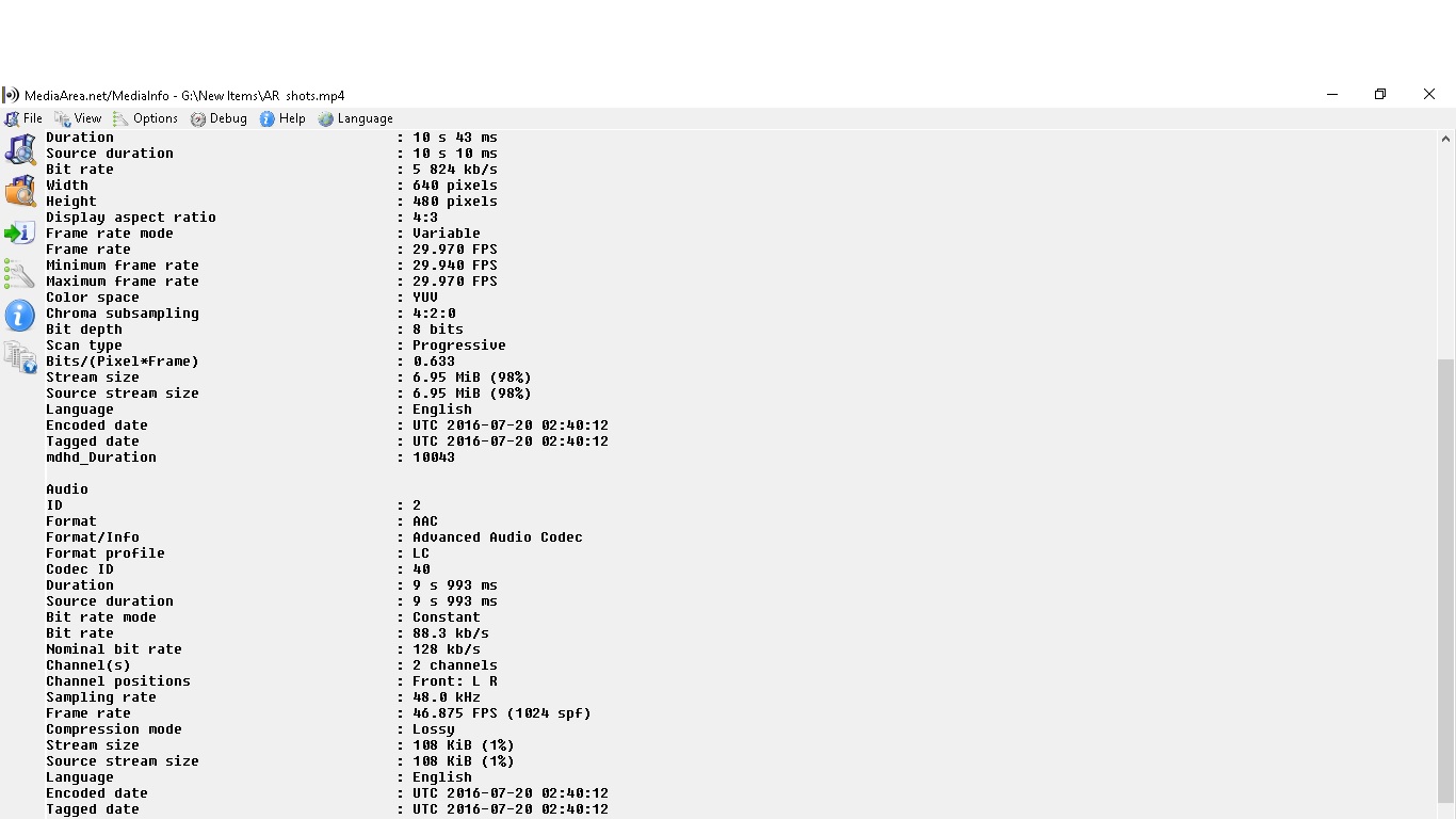

  10. According to your screen dump AR shots.mp4 has audio with AAC LC codec (Advanced Audio Codec Low Complexity). Since it's just 7 MB you could attach it to a post. Your settings in PowerDirector12 could have muted it?
    And using MediaInfo View -> Text would give you an output like

    Very well. I am attaching the video and also a screen shot of the audio information as mentioned. Sorry about the second image. I don't know why that got on there even after I removed it.
    https://www.youtube.com/watch?v=azDa6LGqhes&feature=youtu.be Notice that the audio is absent.
Name:	Audio information.jpg

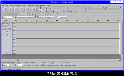

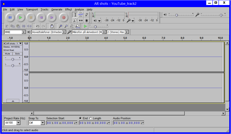

  13. You should attach the orignal to a post instead of using Youtube in the future.
    But
    the audio exist but is muted. The wave form of your Youtube looks like this

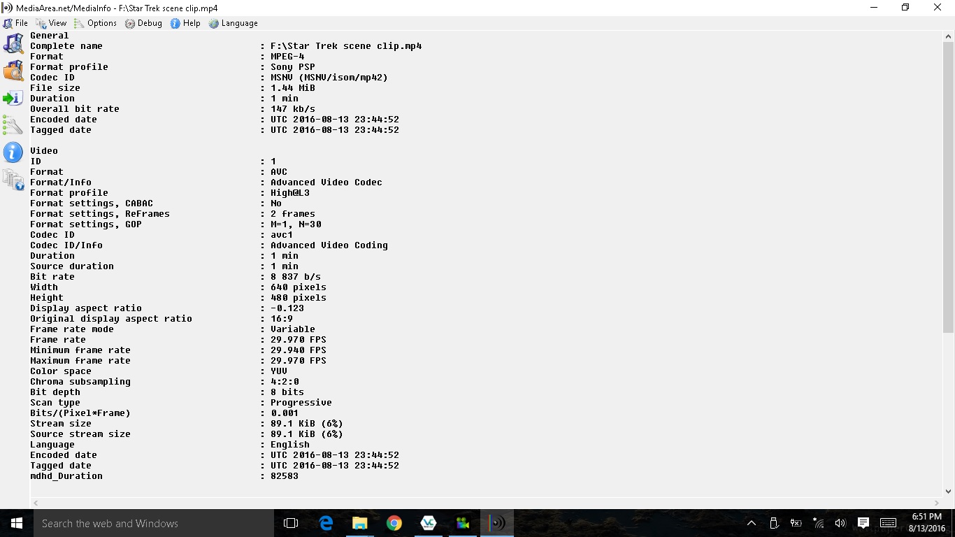

    Ok, then you might be interested in what I'm posting today. I'll address something else I first mentioned in my OP about the other problem that occurs if the audio isn't missing, and that's the video being just a blank green screen. I took a short video that I have which is a clip from a Star Trek movie and I processed it through PD12 without making any changes to the video at all. The video started as an MP4 file that worked perfectly at the beginning. I imported it into PD12, and then simply saved it as an MP4 file--the same as what it started as. I didn't do any editing to it. See the results here. The video is nothing more than a green screen, but the audio is still there. I'm also posting the MediaInfo information for the file. Can you tell me why the screen is blank when I didn't even do anything to change anything about the video?
Name:	Star Trek scene clip info.jpg

  25. Oh yes you changed something. Just because you make a mp4 from a mp4 doesn't mean you don't re-encode it.
    You have a negaive display aspect ratio of -0.123 - probably not the case in the source. Which player is used?
