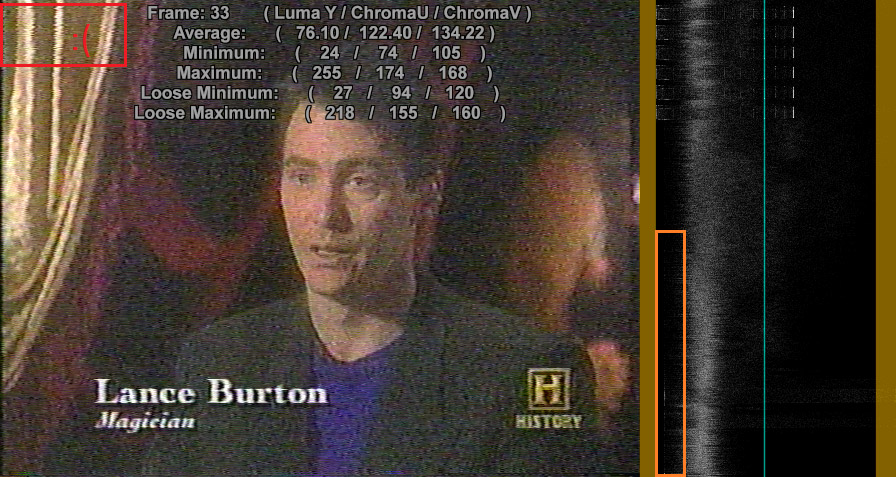

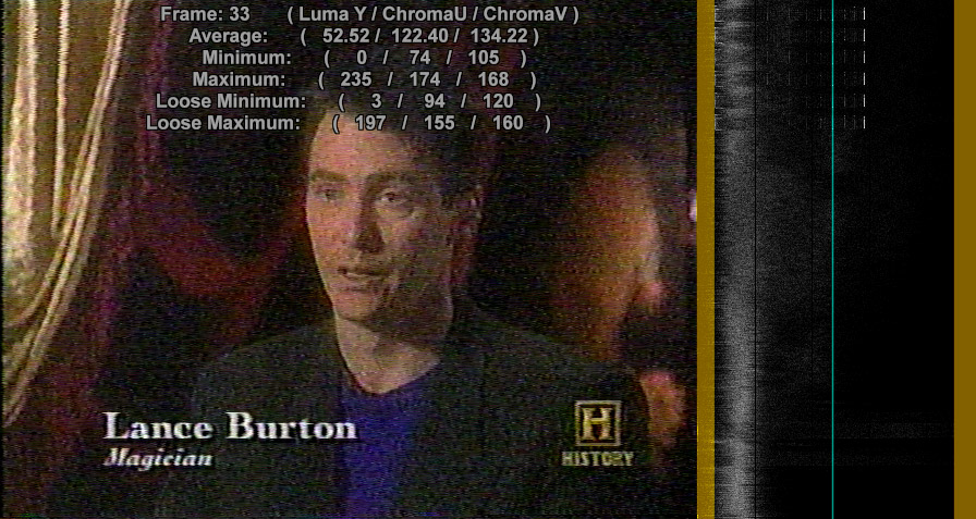

    Just checked Captured.avi and Handbrake.mkv. There is a lot of horizontal jitter. Adding a passthrough line TBC will only cost you money, not time. Not sure whether even they can completely stabilize the image, given the interference-ridden cable TV source, but there should be an improvement.
    https://forum.videohelp.com/threads/319420-Who-uses-a-DVD-recorder-as-a-line-TBC-and-what-do-you-use
    The black level is also way too high. Except for the bottom 3 lines, the lowest Y values are brickwalled at 24 instead of 16 or below. It looks like the Brightness control on the capture device was raised.
    Fixing this is simple enough. Adjust by eye assisted with a histogram/waveform, with one setting for each separate TV recording.

  7. Originally Posted by vaporeon800 View Post
    [Attachment 37989 - Click to enlarge]
    [Attachment 37988 - Click to enlarge]
    Thank you for the advice. Like I said, I know it's not the best method. It's just a "quick" method. Though doing a check of the brightness and contrast before the capture should not add too much time. I will not however be adjusting scene by scene like some do.
    You said adjust to 16 or below. Your screenshot shows 0. Is better to make it 16 since it is a TV source? Am I misunderstanding?
    I had thought of buying a Panasonic ES10 to use as a passthrough. The prices on Ebay are not too bad.
