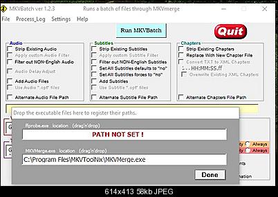

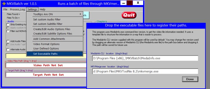

  6. You need to define the settings

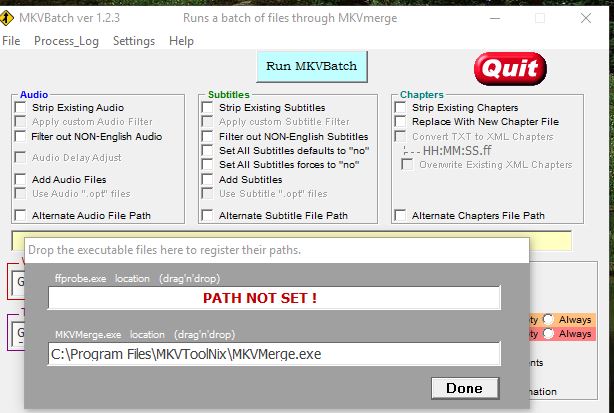

  7. Click image for larger version
    Thanks! I have version 1.2.3 - it has only two lines in the set executables
    ffprobe.exe location
    and mkvMerge.exe location
    There isn't a third line for Media Info CLI and if I put the mediainfo path in the ffprobe.exe drag and drop box is says it isn't ffprobe.
