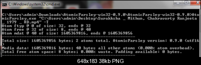

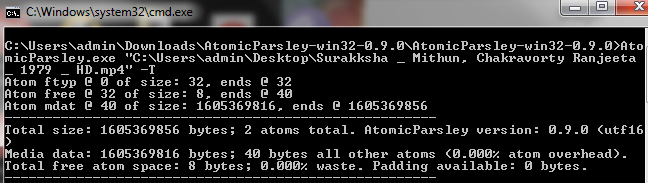

    So then I started to see where the file could be wrong, there were some suggestions to check Atomic Parsley -- See the image Click image for larger version

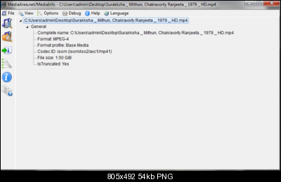

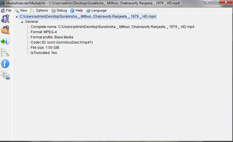

    Also Here is the Media Info of the file (see image)Click image for larger version

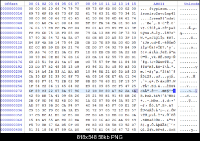

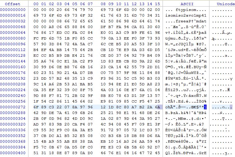

    Also here is the portion of the Hex editor output for the file (See below) and also the imageClick image for larger version
    ... ftypisom....
    isomiso2avc1mp41
    ....freeaPmdat
    ..e.߷ʁ0`
    v.̄.ɹa
    mu.y..?s
    W=rJZlε S?.
    J.ud+.~m
    ̵!v7.y.
    5v.:.ˍ"m
    0.vk.#.BUy-
    `#Q!JuW.
    #WH5.1\Ő.
    .+S.!]#
    529.uJ...j.
    q+.xc?.W
    .T†.Ed..G%
    o"...*j
    .]eHS[%d].
    Based on what I can interpret from my limited knowledge base that somewhere in the MP4 file the headers are corrputed, because when I looked the media info and atomic parsley of known good files i could get expected output.
