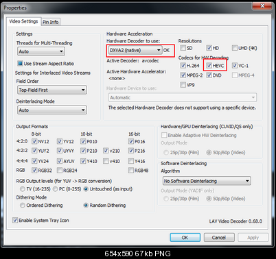

  8. Dinosaur Supervisor KarMa's Avatar
    Jul 2015
    US
    It doesn't help because GTX970 doesn't support HEVC decoding . It's "VP6" , you need "VP7" with feature set "F" for HEVC support (pure video hd 7) .
    https://en.wikipedia.org/wiki/Nvidia_PureVideo
    The less expensive GTX 950,960 support it because they have VP7
    Even my ancient ATI 4670 (2008) card helps with decoding HEVC, via LAV Filters and DXVA2.
    You are also using LAV Filters 0.66, but the current version is 0.68.

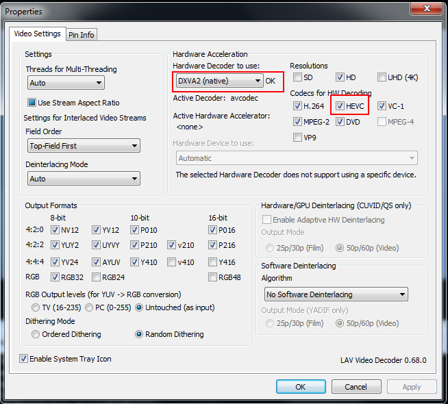

  9. Originally Posted by KarMa View Post
    It doesn't. Just because you can select tick the "HEVC" check-box it doesn't mean it's actually being used. Play an HEVC video an look at "active decoder".

    - Looking at DXVA checker, it says my device supports "DXVA for HEVC_VLD_Main", but when I google around, I see that there's also something called "HEVC_VLD_Main10" which I believe refers to 10-bit HEVC, which is also what the file I'm trying to play is. My DXVA checker doesn't show this, so that probably means it is because the GTX 970 doesn't support it, which would be exactly in line with what my theory is based on what MPC-HC says, as well as what others have said earlier in this thread.
    What version of MPC-HC do you use (number and bits)? Use latest nightly: https://nightly.mpc-hc.org/
    - I was using 1.7.10 64-bit, but now I uninstalled that and installed the latest nightly (MPC-HC 1.7.10.252 64-bit).
    You said that you'd tried updating the LAV Filters - what does it mean?
    - I copied the latest files to LAVFilters in your MPC-HC folder (and made sure they were 64-bit).
    Did you checked what filters/decoders are used when playing your video?
    - Yes, and it uses LAV filters as it is supposed to. But what confused me was that it was using the avcodec decoder when playing HEVC files, while it uses cuvid as the decoder with other files, despite the settings not changing.
    Did you check it with Strongene/Lentoid as well?
    - Yes, I've already tried that, but Lentoid didn't fix anything (and I confirmed that Lentoid was indeed active.)
    - Reading up on that mod, it sounded really promising, but after installing the filters and confirming they're were working, things were unfortunately still the same.
