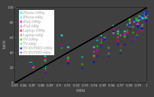

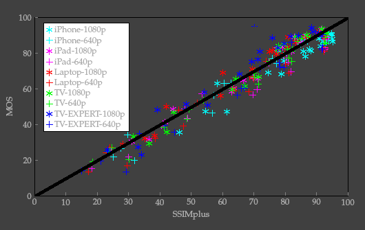

  18. That's true, but we got SSIMPlus now that correlates a lot better to subjective tests. I've attached the graphs. PSNR is utterly worthless. The same score rates the actual quality anywhere from good to garbage. SSIM is more consistent which is no surprise but still dodgy. Now look at our self-explanatory winner. It's a small step for man, people.
    But anyway, I've reduced the bitrate of the VFR encode so that it matches the SSIM+ score of the CFR encode and I got a 74,515 KB file (454 kb/s) compared to the 81,839 KB one. That's 9% bitrate savings for 40% of frames deduplicated. Not too bad actually, it's worth it considering the lower encode time due to less frames.
    So I guess this is the final verdict. The truth is always in the middle. Cornucopia claimed there's no benefit, I claimed there's a 50% benefit. I was half right.
    aq-mode 2 and especially --no-psy should almost never be used
