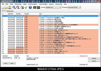

    I have an .srt file but it does not work . Can anyone help me? thanks. it is in chinese but my other .srt files also in chinese works fine.
    1
    00:00:15056 - > 00:00:
    16391
    让我们开始上课
    2
    00:00:16808 - > 00:00:
    18351
    在将最后一个单元
    3
    00:00:18393 - > 00:00:
    19686
    我已经介绍
    4
    00:00:19686 - > 00:00:
    21146
    中国本草概念

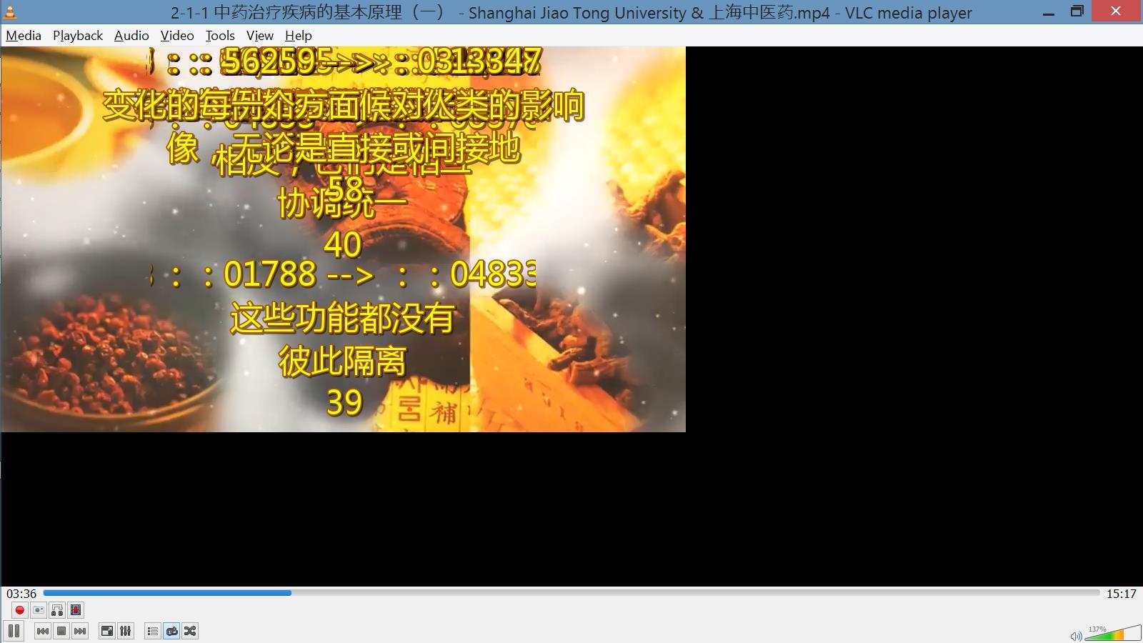

    thanks for your help. I can load it now but its a mess , all the subtitles come out at the same time.
    May I know what you did to enable me to Image
    [Attachment 37871 - Click to enlarge]
    load it?

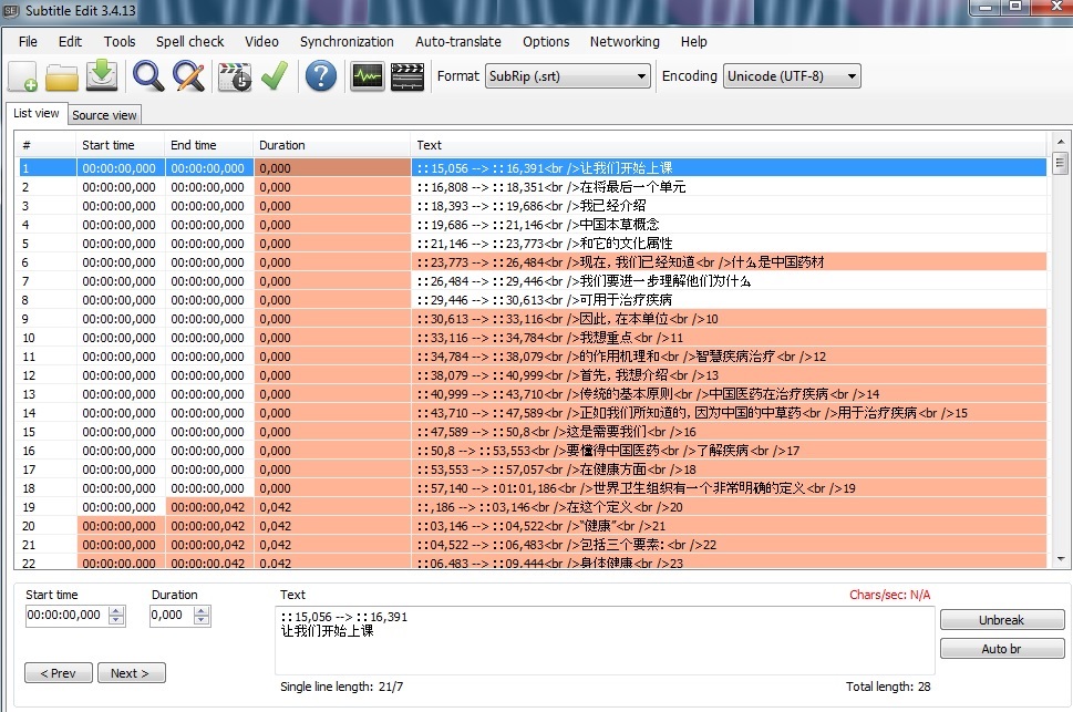

  4. @ winsen
    Hi. Such subtitle has some "tricks" on it. Or same kind of "errors" or "protection" to avoid some editing or copying.
    Here below follow the file edited with srt format pattern. But it is "protected" or containing some kind of "errors".
    When we try to open it using Subtitle Edit all timing / srt format was messed up.
    See above ( picture) and below ( on attachment ) the subtitles with timing / srt pattern "errors".
    But, despite of that, maybe we can editing them to correct srt format / timing pattern.
    The downside is that we may need do it manually, line by line, one by one.
    I don't know how to do it properly yet.
    Best regards.
    devil (johner)

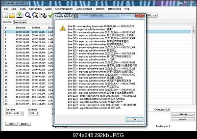

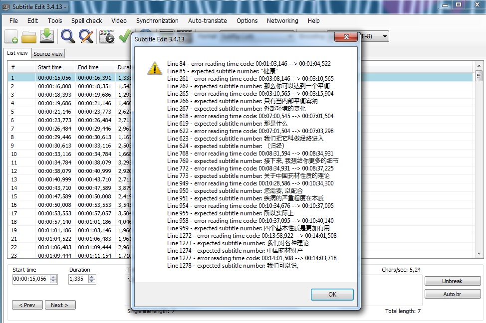

    Hi. I open the subtitle using Subtitle Edit and the program give me the following message.
    After that, I save a new subtitle. And manually make a timing correction on line 173:
    173
    00:08:147,44 --> 00:08:16,496
    值得注意的是, 当我们谈论的毒性
    I don't know why, when I save using Subtitle Edit line 173 change the timing automatically, like this:
    173
    00:10:27,044 --> 00:08:16,496
    值得注意的是, 当我们谈论的毒性
    So, I need to correct it manually, using some text editor.
    After that, I could open such new subtitle without any complains using Subtitle Edit . Except line 173, which one insist appears using "old time".
    Now, you can test the subtitle and see if it runs nice on videos.
    I don't know if the previous messages will cause any problems on the subtitle. You must test and make all the corrections needed.
    Thanks.
    Best regards.
    devil (johner)
