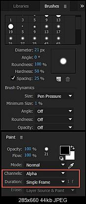

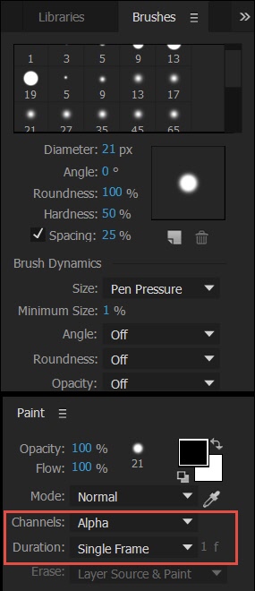

    1) right click layer 1 => open layer. This is the layer panel. You can drag and dock / re-arrange / place the panels wherever you want. The way I have it setup in the video is composition panel is on the left, layer panel is on the right. The comp panel is the "final" view. The layer panel is where you "paint".
    2) Select the brush (or ctrl+b). The 2 important settings for the paint mode - it has to be set to channels: alpha , duration: single frame . The others you can experiment with , brush size etc... hardness is the another one you'll want to play with - that controls the amount of feathering or edge blending between the 2 layers
Name:	paint settings.jpg
    3) Move to the defect, hold down LMB, paint over the defect, release LMB. Repeat. To advance to next frame , <page up> is the default shortcut key in AE. <page down> is backwards.
    Anyways that's the basics. I've purposely done it slowly in the video, missed some spots and had to go over some lines twice (ok maybe not purposely for that, I just clumsily missed a few ) - but I'm sure you can the general impression that it's quite easy to do. You can combine with some of the other techniques - your "base" layer might be a modified median stack for example.
