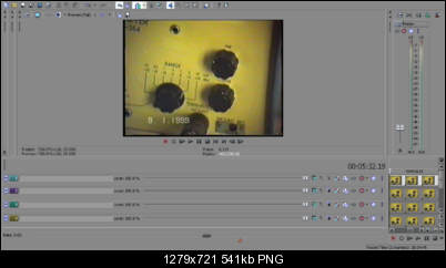

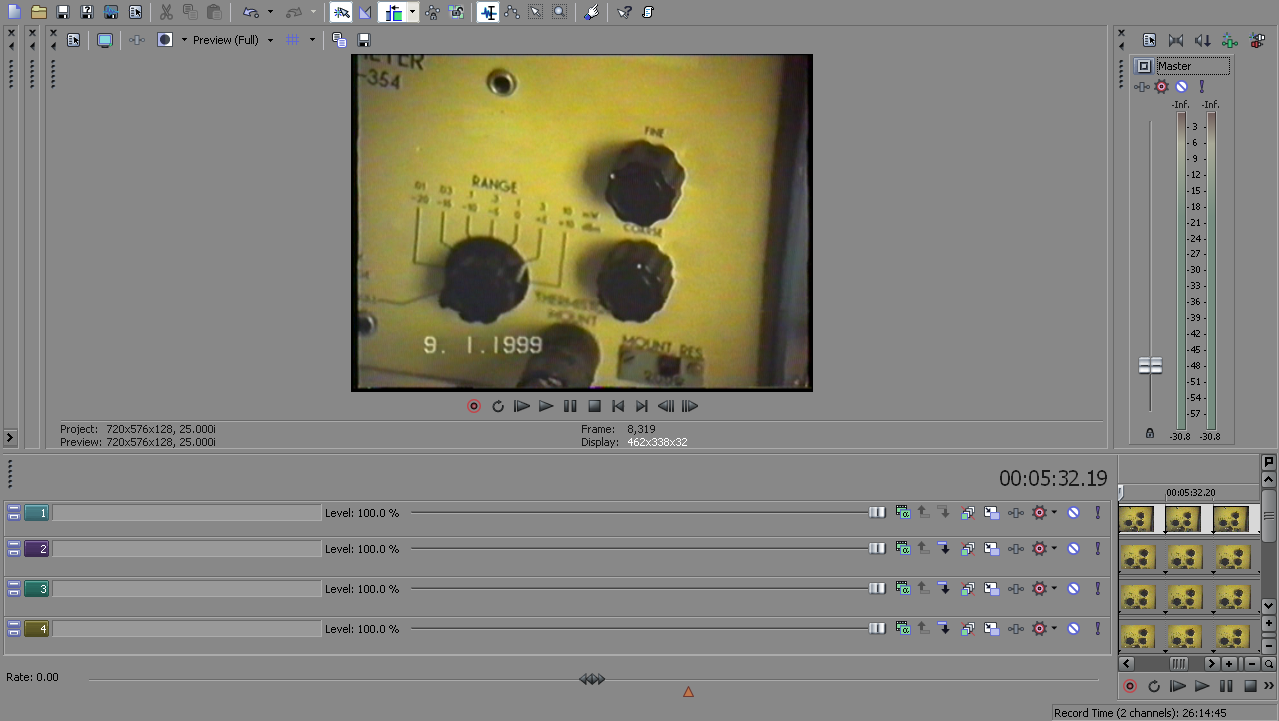

  10. Poisondeathray, the current setup in Vegas is as follows:
    The 4 videos are aligned on 4 tracks. The frame of the 1st track is visible on the display, and the 1st track is repaired; that will be the output. On the Wacom tablet there is one button for stepping forward one frame, one button for backward, a third for ctrl+c to copy, and a fourth for ctrl+v to paste.
    With my 4 fingers of the left hand constantly over these buttons watch the display and scroll through the video frame by frame. When a serious blemish, (usually a static line) appears, then I click the solo button on the track 2. to see if that is good enough as a replacement. If not, then I will solo the third track and/or the fourth track. If a better frame is found then I click on the good frame on the track that holds it. This will select the right track and right frame to copy from.
    Next I press the copy button on the tablet, which is the 1st click of the copy-paste operation. Then I click on the frame on the 1st track that should be replaced (2nd click). And finally press the paste button on the tablet (3rd click). The clicking on the solo buttons and tracks can be done very fast with the pen, but that tends to be sometimes unstable and it does things I did not intend. Using the mouse to click is slower and takes more finger training, but it is completely stable and reliable. The following options are enabled:
    Auto ripple is on
    Options:
    Enable snapping
    Snap to grid
    Snap to markers
    Snap to all events
    Options>Preferences>Editing:
    Do not quantize to frames for audio-only edits
    New still image length 0.04 seconds (1 frame at 25fps)
    There are only about 3 frames allowed to be displayed on the tracks as seen on the attached image in order to minimize horizontal arm movements.

  16. Poisondeathray,
    I have tested multicamera editing in Vegas Pro 10.0, and I would certainly use it, if it would be easy to detect temporal misalignments on the side by side displays. Unfortunately in this mode there is no possibility to use solo buttons to quickly swap back and forth between frames and recognize even slight movements on the same display.
    If the movement of the scene is fast, then it is ease to recognize the difference between two adjacent frames even on side by side displays. It is also easy to see the difference when the movement is slow but the temporal misalignment is worse than just 1 or 2 frames. One starts to hesitate only when the movement is slow, and the temporal misalignment is only one or two frames.
    The visual recognition of a misalignment on side by side displays is based on comparing the relative position of objects, which is not very reliable if the difference is small, and time consuming when one has to hesitate and doubt. This way one is not wasting time and work on clicking buttons, but wasting time on moving one’s eyes left and right and on thinking. So the work is shifted from one’s fingers to the eyes and brain.
    Using a single display and solo buttons the work is mainly done by fingers clicking and swapping the frames, but there is no hesitation, and one can recognize even the slightest misalignment unmistakably. You just look at the display, toggle the solo button and if you see any slight movement or flicker (except for blemishes), they are not temporally identical frames, therefore can not replace each other. The work load has been shifted from the eye movements and thinking to the fingers.
    An addition very useful benefit of using this toggling is that one can not only recognize temporal misalignments, but also subtle blemishes that are present on one frame, but not present on the other (and which would be extremely difficult to see on side by side frames). Sometimes even when two frames are in alignment and the alternative frame does not contain the static line, it can contain other blemishes which are as bad as the static.
    The best solution is the combination of both, the multicam and the single display simultaneously. In this case, if one is certain that two frames are identical on the side by side displays, then just work in multicam mode. When uncertainty sets is, then one could use the single display solo toggling to look for any movement.

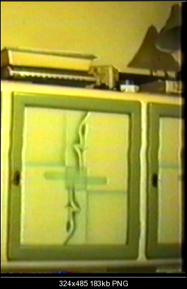

    Here is one of the restoration problems to be solved in advance: there is an ugly vertical wavy distortion in the video (although not too disturbing, but better gone), which might be possible to fix with a special filter that straightens the frames based on the curvature of the edge of the video. Perhaps the DeJitter filter of Vcmohan or similar could fix (or at least improve) this issue. Here is an example where the vertical waving of straight edges is visible.
    If anybody has suggestions how to fix this distortion, please add some wisdom to this thread.
    I have disabled the deinterlace option in in MPCHC and did not see any combing, therefore it looks like the videos are not interlaced.
    The device on the sample video is a microwave signal generator with an attached passive amplifier.

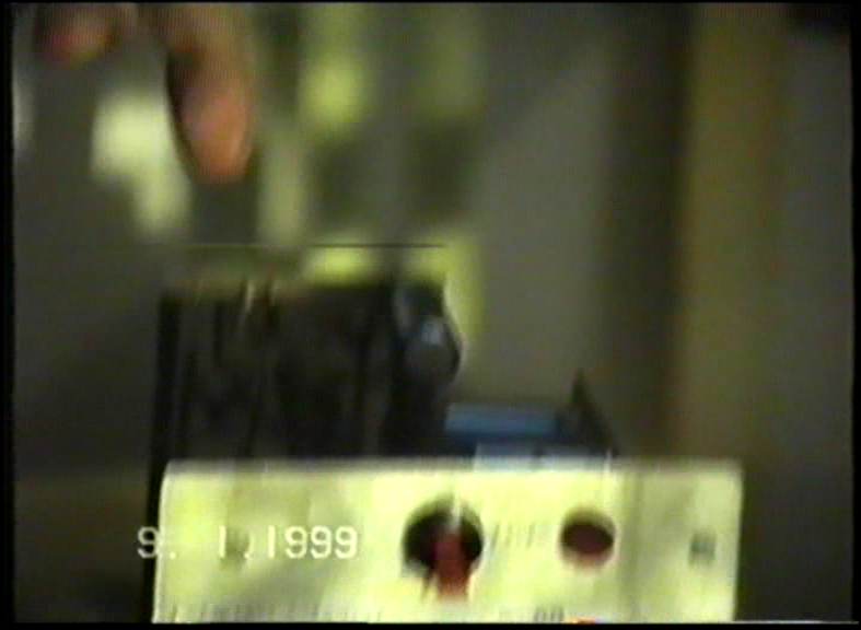

    Here is an example bad fame with a static line, which could not be replaced by a good alternative; and how it was retouched in Photoshop in about 20-25 seconds without any experience using the healing tool (similar result can be achieved with the content aware spot healing tool). After fixing a hundred of them, the time required, and quality can get even better.
    No, that would be partially incorrect - there are valid spatial alternatives (mix & match parts of frames) . Masking or alpha paint. You're thinking of "whole frames". Think of it like a jigsaw puzzle where you mix and match parts of frames from 1,2,3,4. Really you only need 1,2 for 99% of it. Very few need to resort to 3,4. If it doesn't make sense maybe I can explain it farther or post a short video tutorial. A video is really worth 10,000 words

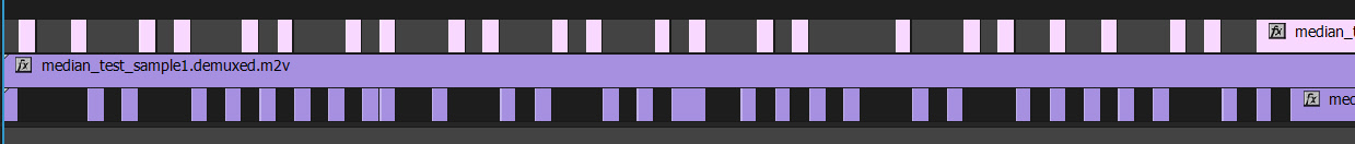

  30. I've manually aligned 3 & 4 to 1, with transparent gaps for the 1st 10 seconds (0-250 frames) to test to see if it would help, or even if it's worth exploring whether it can be automated as a proof of concept for now . Just fiddling around with it, 3&4 are also less spatially aligned than 1&2, so my impression is it actually can make some things worse, not just the defect areas
    A screenshot of an excerpt from the timeline and how they are arranged looks like this, but I'm sure you get the general idea - there isn't full coverage with 3+4 overlaid (there are still "holes"), and there are different unique frames from each 3&4 (so in that sense you're sort of "wasting" some frames with a simple 3 on 4 overlay , or a 4 on 3 overlay). The more aligned capture sequences you have, the more "random" defects like those "lines" should be cancelled out. But the true alignment is important if you wanted to use multicam, or even layer visibility or soloing, or any other compositing techniques like alpha painting - otherwise you pick the wrong frame
    The top is 4, middle is 1 (used for reference timing), bottom is 3.
    But there might be some manipulations, both spatial and math /layer operations and combinations that you can do to improve the median stack outcome so play with the samples. jagabo will probably come up with something. Lagarith RGBA
    @Zoltan, I'll put together a better description of the alpha paint reveal technique later today with a short video demonstration. The method is exactly the same in AE CS4
