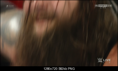

  1. @jagabo, I think post#30 was mflowfps, not interframe. He's claiming "no glitches at all" with interframe, but I'm seeing almost as many. Or maybe he's defining "glitches" differently than I am. Or maybe my interframe is producing worse results for some reason. The logo/overlays are definitely cleaner IMO than the other motion interpolation method, at the expense of strobing/ blurring
    I tried swapping different svpflow .dll's on 2 different computers (albeit Nvidia, maybe ATI doesn't have this issue but I doubt it), and GPU=true is definitely worse, definitely frame edge artifacts compared to GPU=false . I also tried the v4 dll's instead of the v2 dll's. All have the same issues
    I encoded single threaded, cores=1 to be sure . I found you need to go back a few frames, maybe 20 or so and advance frame by frame or you'd get slighly different results, even in single threaded mode. So either that or physical linear encoding. These screenshots are from linear encodes, not previews. GPU=true has more "blobby" prototypical edge morphing artifacts at the frame borders, the lower frame border in this case. The edge artifacts disappear with GPU=false, but the other artifacts such as overlay artifacts are still there
    These types of frame border artifacts are distracting in motion, just like the overlay/logo artifacts are "flickery" and distracting. My personal opinion - I wouldn't use interframe or any motion interpolation on these types of sports/action videos
    GPU=true
    GPU=false

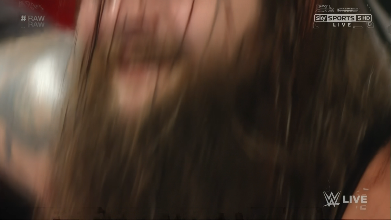

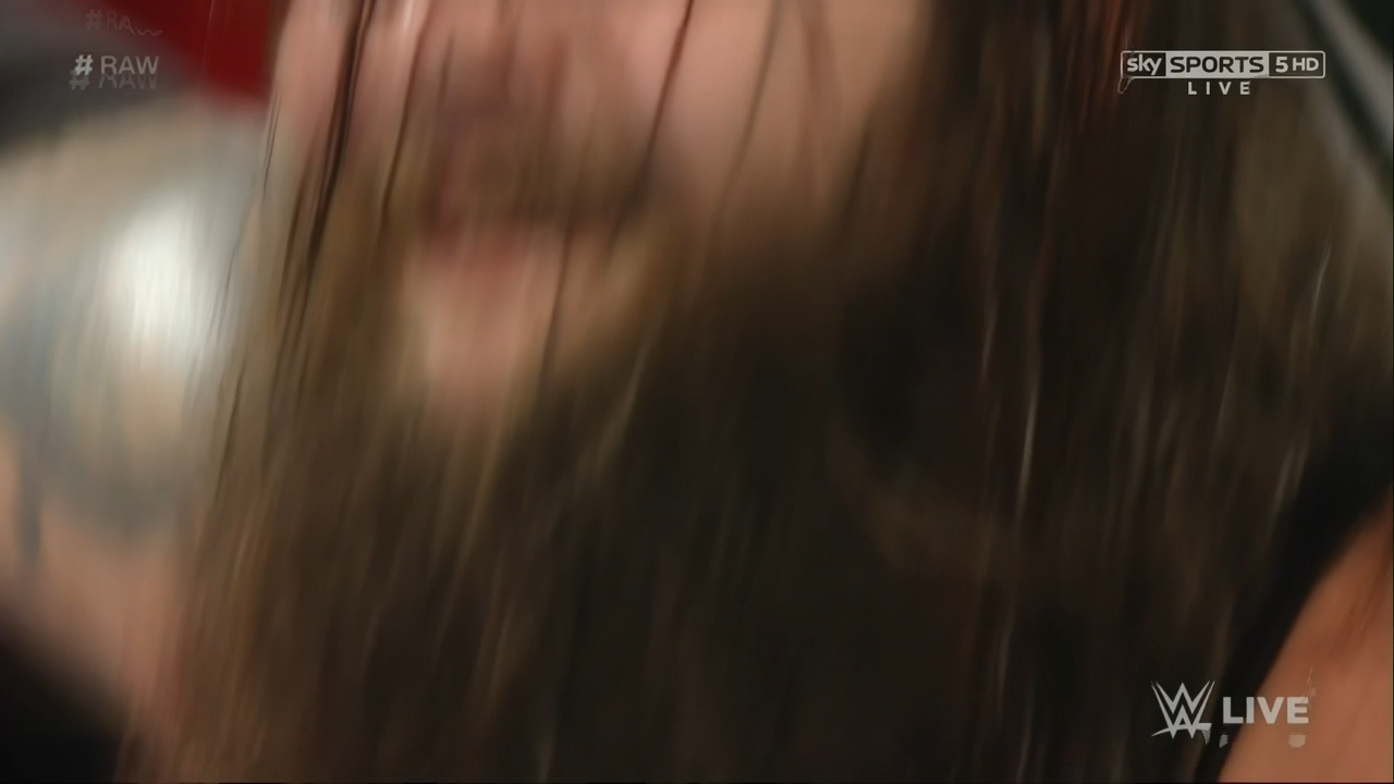

  11. The video you posted in #30 is really, really bad. There are huge artifacts in all vertical lines, as I already mentioned. By contrast, while you are correct that the logos do break up a bit, the rest of the video that I provided in my earlier post beats your Interframe example in almost every case. I just lined up the original, your Interframe, and my MFlowFPS result, and there really isn't any place where your Interframe script produces a better result. For instance:
    Your InterFrame
    My MFLowFPS
    As already mentioned in almost every post, motion estimation technology is going to fail at times, and if you don't like that, then use ConvertFPS, as has already been suggested. Alternatively, if this project is really important, you can use a combination of motion estimation and either ConvertFPS or a field blending technology, switching to the field blending or field duplicating version via a mask, when needed.
