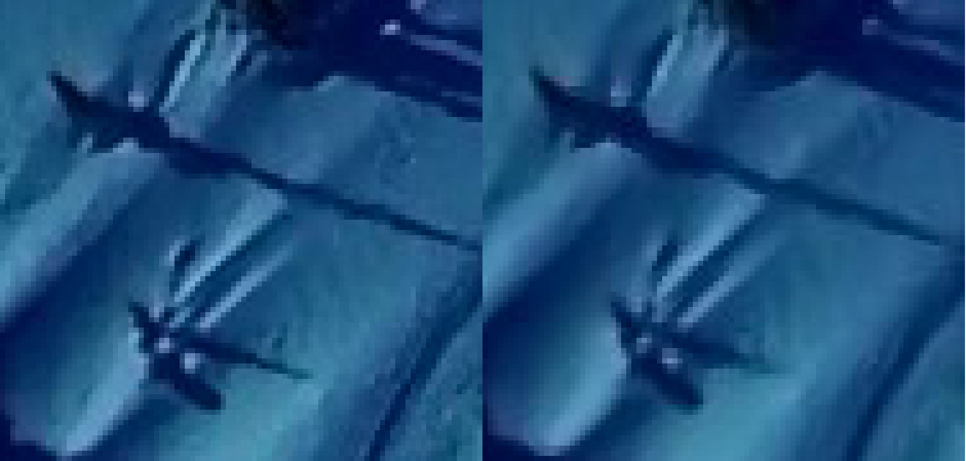

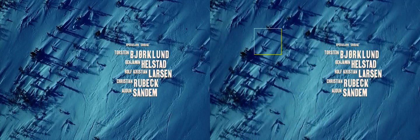

    I guess I jinxed myself with my last post. Last night I watched the disc I created using my Panasonic player. The video is great and converted well with just a small loss of sharpness but still isn't bad for a DVD even on the big screen. Motion conversion was very good with no judder nor noticeable artifacts. My lasting problem is the subtitles. They appear just fine using my laptop and the MPC HC player but with my stand-alone Panasonic, they are at the far bottom of the screen and many times, some are cut off and don't show.
    I did a frame grab from the original PAL and the converted NTSC disc just to illustrate resolution and in doing so, noticed that the PAL frames are almost square and need to be stretched horizontally to fit the 16:9 format. The NTSC frames fit without being stretched. From that I might assume that the subtitle frame is not being stretched and when centered, the text is positioned where it is. Why the MPC player would get it right is a mystery.
    Anyway, I'm open to suggestions (again). If there isn't a cure for this, I could be back to using johnmeyer's suggestion for watching the disc set.
    I'm attaching the frame grabs along with an enlargement of each (yellow highlighted area) just to show the conversion quality. The left is the original PAL frame and the right is the converted NTSC frame. The PAL frame was adjusted in photoshop to the proper aspect ratio to match the NTSC frame.
