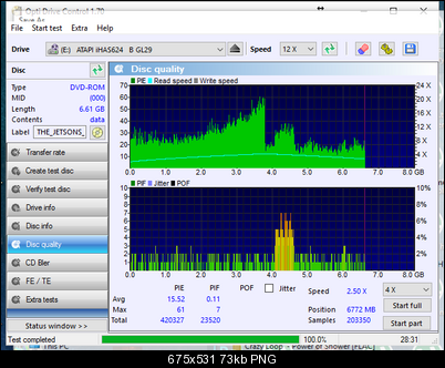

  1. I have a DVD retail pressed and 2 copies of this DVD SET. I noticed one set has much much thinner discs....than the other. Is it possible the factory they came out of (probably the same) messed up on 1 set and made it THINNER in terms of the polycarbonate layer? It just seems odd but I can't tell.... They are legit from Amazon though. Some seem too similar to tell, and one in particular feels thicker.
    Both sets have pressed stamper/hub codes. The thinner ones say "made in canada"

  3. I'm more concerned with longevity of the discs..but I imagine there's too many factors. I'm running them each through Opti Drive disc qualtiy check now.
    Here's the "thinner one"

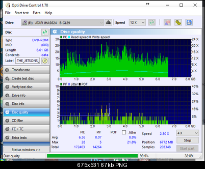

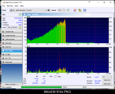

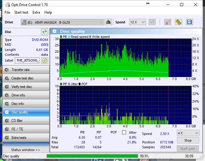

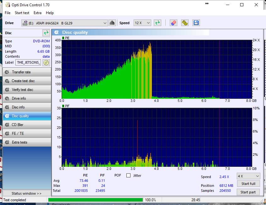

  4. The "thicker one"
    I'm shocked to see this one is worse....anyone disagree?

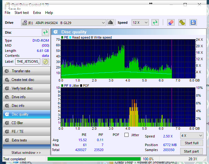

  7. Click image for larger version
    Another disc from the Jetsons. No scratches..no smudges
