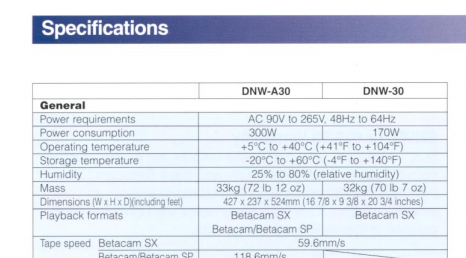

  1. I have a DNW-A30, and I am wondering if it will be able to play DigiBeta?

    It seems to me that if the official specifications make no mention of Digital Betacam, then this model does not support it. And as I recall, SX uses the Betamax size cassettes, not the flattish digital cassettes.

  4. Member Cornucopia's Avatar
    There is a hierarchy to the Sony beta family of tape formats where the more advanced format decks can play lesser formats (aka backwards compatible), but not the reverse (forward compatible).
    In descending order (if I'm remembering correctly) of mainly pro formats:
    HDcam SR
    HDcam
    Digibeta (Digital Betacam)
    Betacam IMX
    Betacam SX
    Betacam SP
    Betacam
    Betamax (sometimes)
    And in the prosumer arena, a similar thing occurs:
    EDBeta
    SuperBeta
    Betamax
