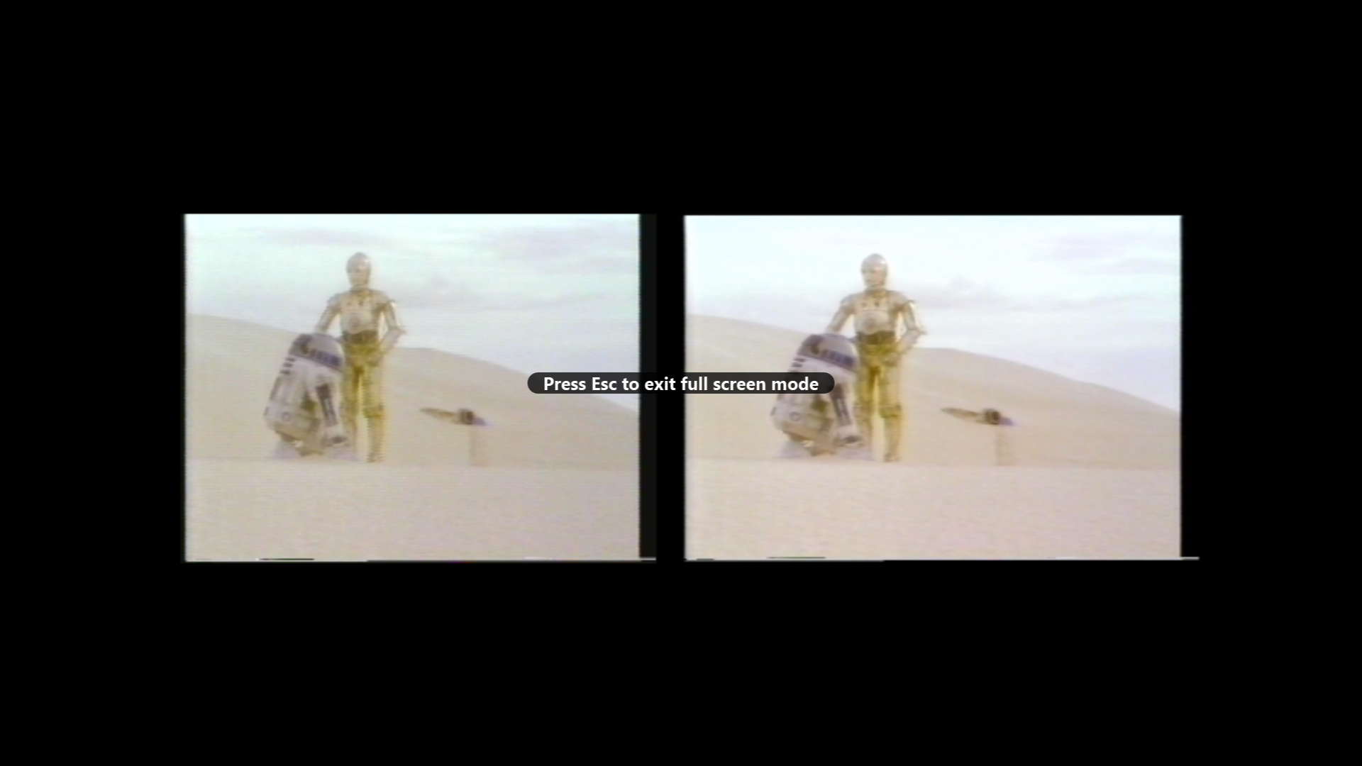

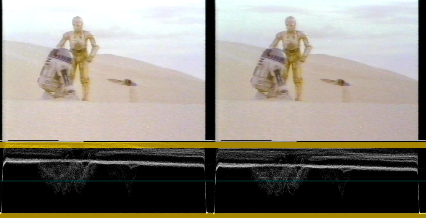

  3. manono was right, the problem is your source has brights over Y=235 and those are being crushed upon display with some editors/players. The black level doesn't look right either -- but I don't want to judge just from this short clip (which maybe wasn't meant to have deep blacks). If you add ColorYUV(gain_y=-20) or ColorYUV(off_y=-20) you will tame those bright areas. But what you really need to do is capture again with video proc amp settings that don't blow out the brights. Original and ColorYUV(gain_y=-20):
    [Attachment 40231 - Click to enlarge]

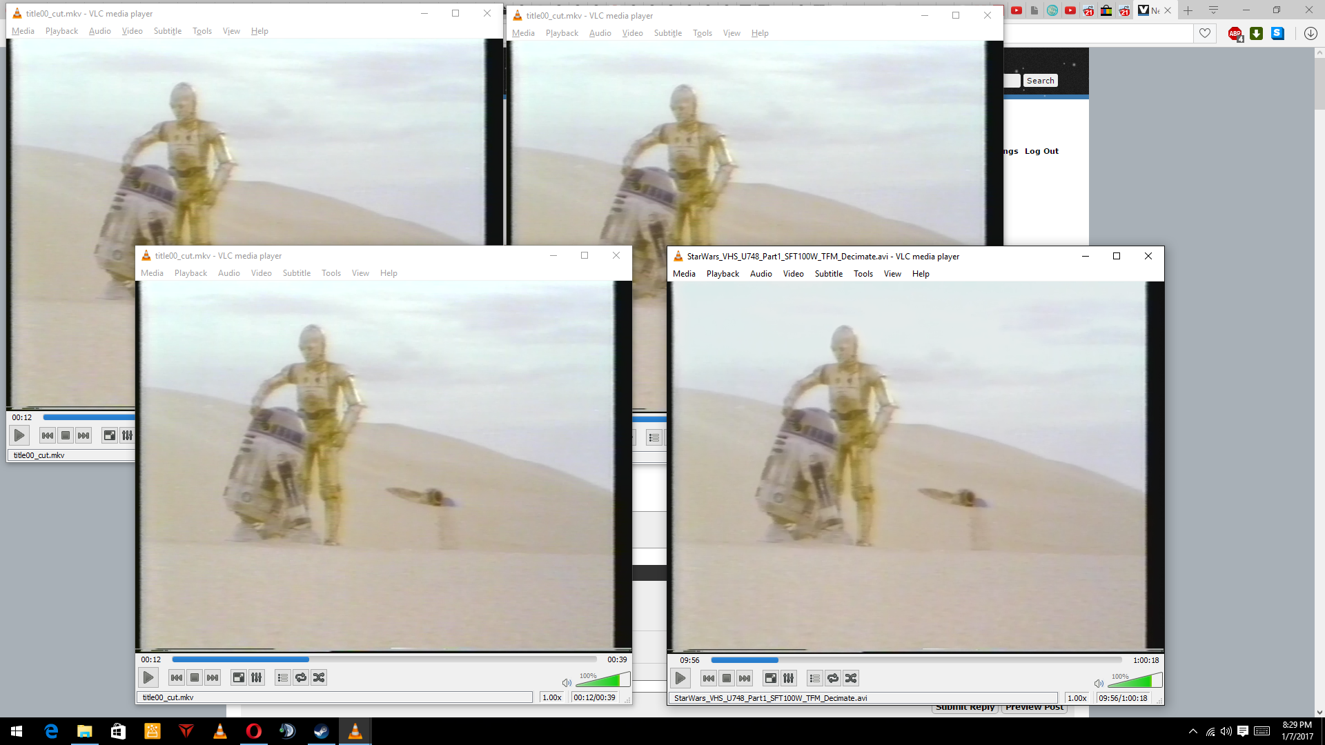

    Sure, I can use that. Do you have any thoughts on why that video I sent you displays fine within VLC, regardless of the number of copies opened? It doesn't seem to be an overlay issue. However, the output from AVISynth/VDub seems to be the only file that has the display issue. (Note there are 3 copies of the file I sent you and 1of the TFM/Decimate version in the image).
    [Attachment 40232 - Click to enlarge]
    The issue is also present in VEGAS if rendered side by side (didn't take time to correct their size/aspect ratio):
    [Attachment 40233 - Click to enlarge]
  6. The difference in display with different programs has to do with how the programs and graphics drivers are set up. Basically, all YUV video uses a limited range where Y=16 is full black, Y=235 is full white. At playback that range is expanded to RGB=0 for black, RGB=255 for white. Y values below 16 all become the same shade of black, Y values over 235 all become the same shade of white (ie, your video isn't supposed to have those out-of-range values). You need to make sure your players and graphics card are set up to make this conversion correctly.

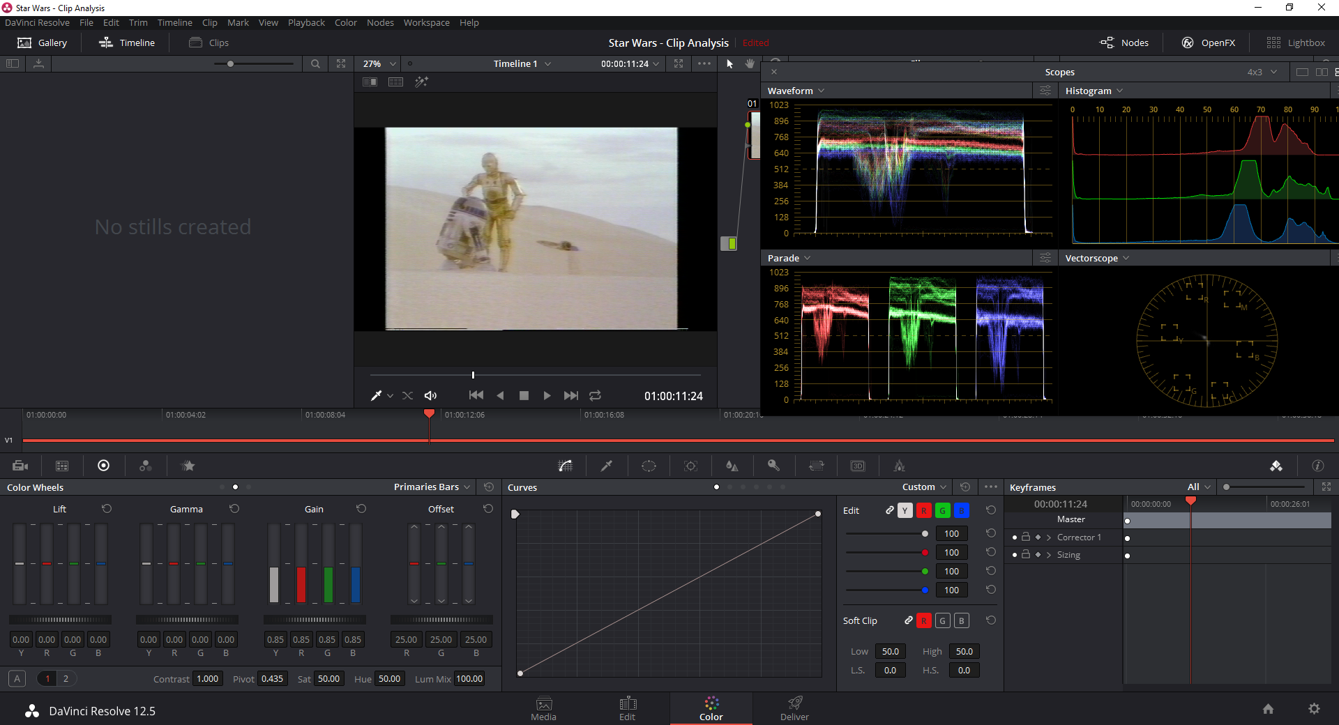

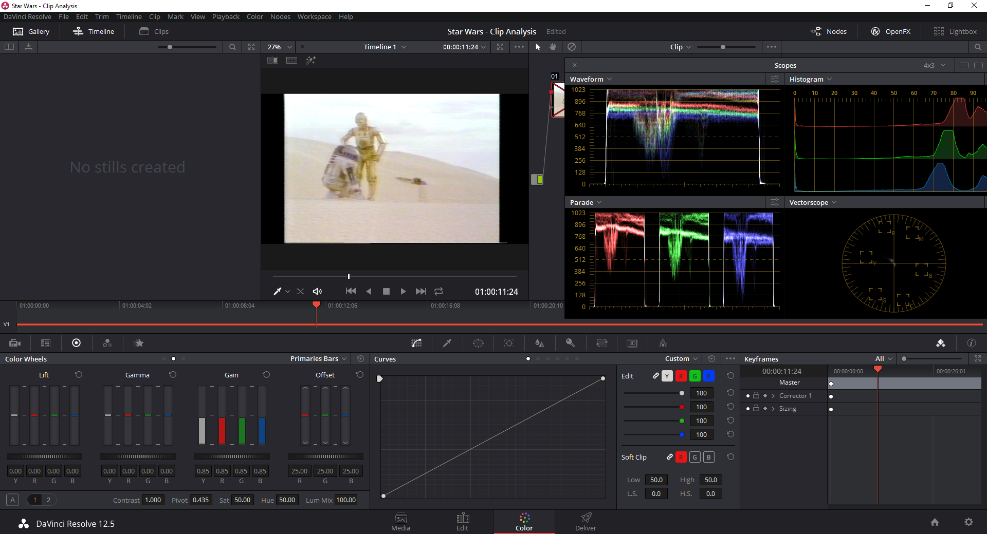

    I've looked at the histogram in AVIsynth and I've also pulled the video into Resolve and looked at the channel histograms. It does seem that the birghtness is getting clipped. I'm curious what's causing that though as reducing the gain causes the crushed brights to separate out, which seems to point to there being different data for them in the file (it's not completely crushed out in the file, e.g., those pixels that are displaying maximum intensity aren't all set to the same value). Also, since VLC and VEGAS can display the original capture without crushing the brights... what's pushing them up in VirtualDub/AVIsynth/Resolve?
    Just trying to understand what's happening there. What's causing the same data to be displayed differently depending on the program and file format?
    [Attachment 40234 - Click to enlarge]
    [Attachment 40235 - Click to enlarge]

    This first Resolve image in my post should have been this. The first and second are duplicated above. The clip as it appears without applying the Gain reduction node:
    [Attachment 40237 - Click to enlarge]

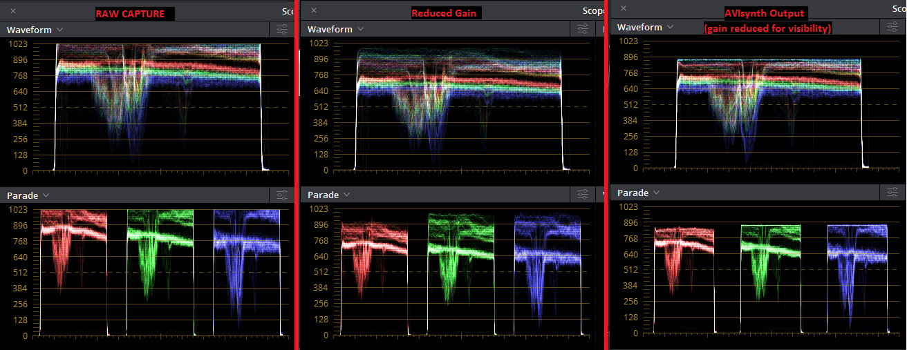

    A good summary of what I'm seeing:
    [Attachment 40238 - Click to enlarge]
  10. Your graph of AviSynth's output isn't directly from AviSynth -- you saved the video with an editor and that crushed the brights.
    Ah, that would be VirtualDub.
    I'll work on getting the gain within acceptable levels across the video and redo the processing on it. Thanks again for your insights
