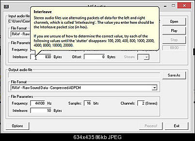

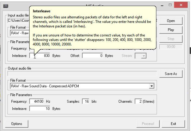

    Coondog1234: I'm not sure, I think it's hex When I hover over the box where you type in the interleave number I get thisClick image for larger version
    So yes it is hex.
