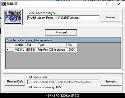

    So I've been a few recording TV shows on a usb flash drive via the option available for the same in my ABS Set top box (cable box). Whilst I can replay these recorded shows on the TV itself through the interface of the same set top box, I need your help to figure out how to play these files on a laptop/ convert these files for viewing on other devices.
    These files are stored in the flash drive as chunk.1, chunk.2 etc. Since I did not think that these were video files, I tried checking the file type with TrIDNET and here's the result:
    None of of the video converters I tried seem capable of recognizing this file type. I tried mounting it on a virtual disk like a .bin file to no avail.
    Any idea what I could do with these files?

    The method most likely to produce results in a reasonable amount of time is playing the recordings using the cable box and re-recording the output from the box with a capture device.
    Typically recordings made by a cable box are encrypted to ensure they are playable only with the individual unit which made them, as well as being stored in many small pieces using a user unfriendly proprietary file system.
    If they are encrypted, you would need an expert cryptologist with a lot of time on his hands to figure out how to undo the encryption. Even if they are not encrypted, it is still likely to take a long time to figure out the file system and how to convert them to something playable.
