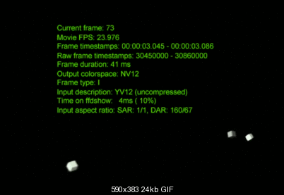

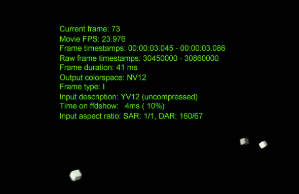

    If you have ffdshow installed, it's on-screen-display can display timecodes and frame rates. That's probably the easiest way to do it. or Potplayer might have something similar built-in. If you extract the timecodes (gMKVExtractGUI will do it) you get a large text file containing lots of numbers that would take a lot of time to check.
    The frame durations are generally to the nearest millisecond, so for a 23.976fps video it'll alternate between 41ms and 42ms frame durations. That's normal.
