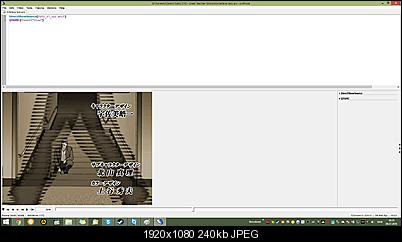

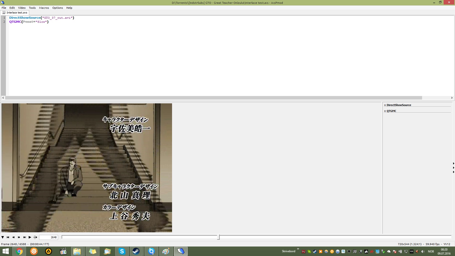

    Its really hard for me to describe this, but it worked just fine a moment ago, suddenly all my damn programs wont deinterlace my newly purchased GTO DVD Collection for some odd reason.
    QTGMC worked fine the first run, second run this issue appeared.
    I then tried Hybrid Video Converter, same issue.
    Then I tried Handbrake also the same issue.
    What is going on here? Are there any files i must clear away?

  2. I suspect DirectShowSource() is messing with the video before giving it to QTGMC. Use DgIndex/Mpeg2Source for DVDs.
  3. Formerly 'vaporeon800' Brad's Avatar
    Apr 2001
    Vancouver, Canada
    720x544 AVI. What are you doing to create this AVI from your DVD?
    The video has been vertically resized before deinterlacing, corrupting the structure.
  4. Originally Posted by vaporeon800 View Post
    720x544 AVI.
    I missed that. Yes, it's probably a bad resize before DirectShowSource(). Again, DgIndex/Mpeg2Source() should be used with DVDs.

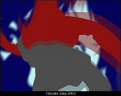

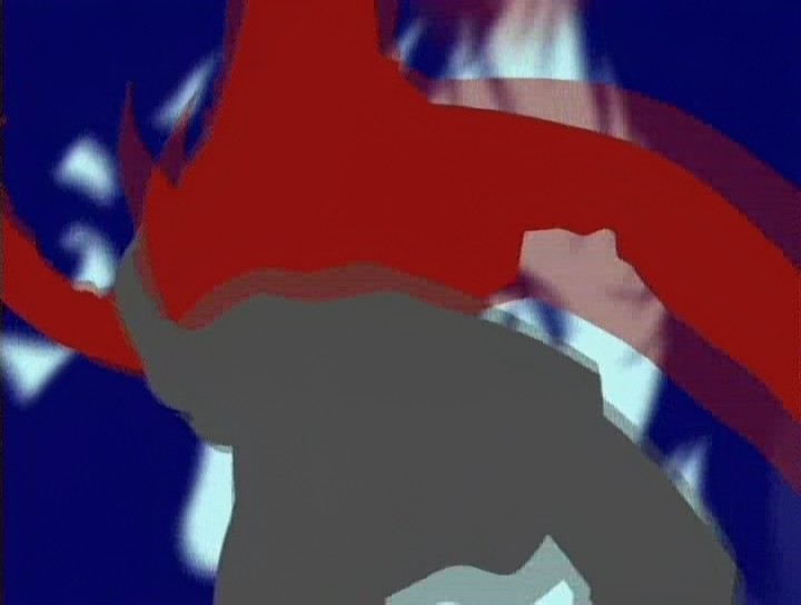

    Another weird thing, at first I thought I had to do inverse telecine.
    FieldDeinterlace()
    Telecide()
    Decimate()
Name:	Interlace test001648_Inverse-Telecine.jpg
    That seems to work, but I get these terrible ghosting images, is there any way to fix this or is there a way to actually reverse the bad up-size back to 480i I guess that is what they used since this might be an up-scaled Japanese edition since they are both region 2

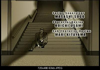

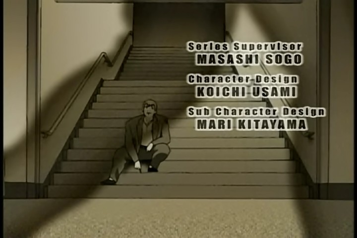

    I went to the store and returned it, I got a proper release after that, however its American release for Europe so its 480i29 and not 576i25 as apparently all of these are unofficial up-scales according to some guy who work for a publisher, this one is among the unofficial ones apparently that I bought scaled at 540p for some odd reasons.
    I re-applied the script and it all works really well now.
    BEFORE
Name:	Interlace test001268_Before.jpg
    AFTER
Name:	Interlace test001268_After.jpg
    AFTER2
Name:	Interlace test001268_After2.jpg
    AFTER3
Name:	Interlace test001268_After3.jpg
    Thanks for the help guys, in the end it was just a bad copy and I got scammed, all the internal files looked just like a DVD which made me trust it in the first place, it had the menus and all but the quality compared to the proper 480i29 release.
