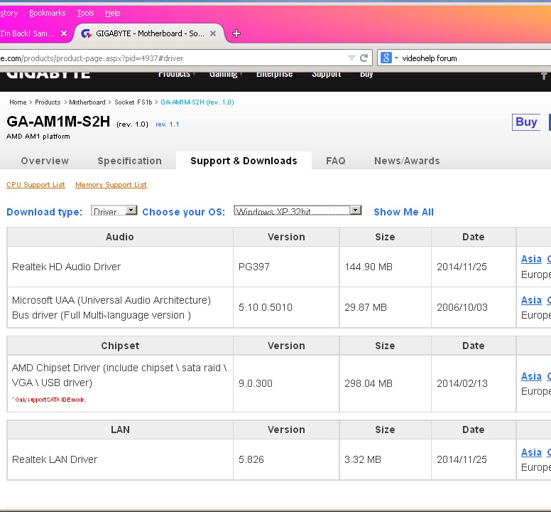

    At gigabyte: d/l drivers os xp32 bit= no sata/raid/ahci. Chipset driver = almost 300 meg on floppy? not!

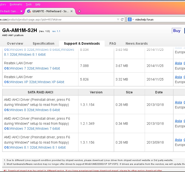

    " " " " all os's listed for: 8-7-8.1, not for XP am I looking in all the wrong places?

    It is possible that there are no AHCI drivers available. Gigabyte specifically said ""Support for Windows XP 32-bit" with the footnote "Only support SATA IDE mode."
    [Edit]Look at the screenshot showing the available XP drivers. The chipset drivers for XP also contain a footnote stating "Only support SATA IDE mode."
